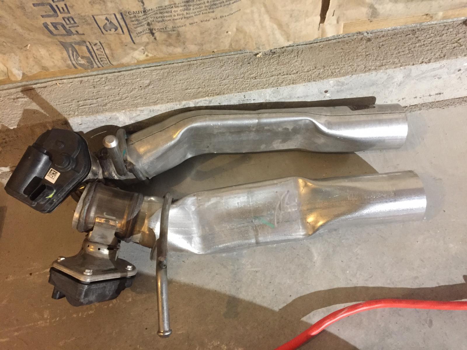

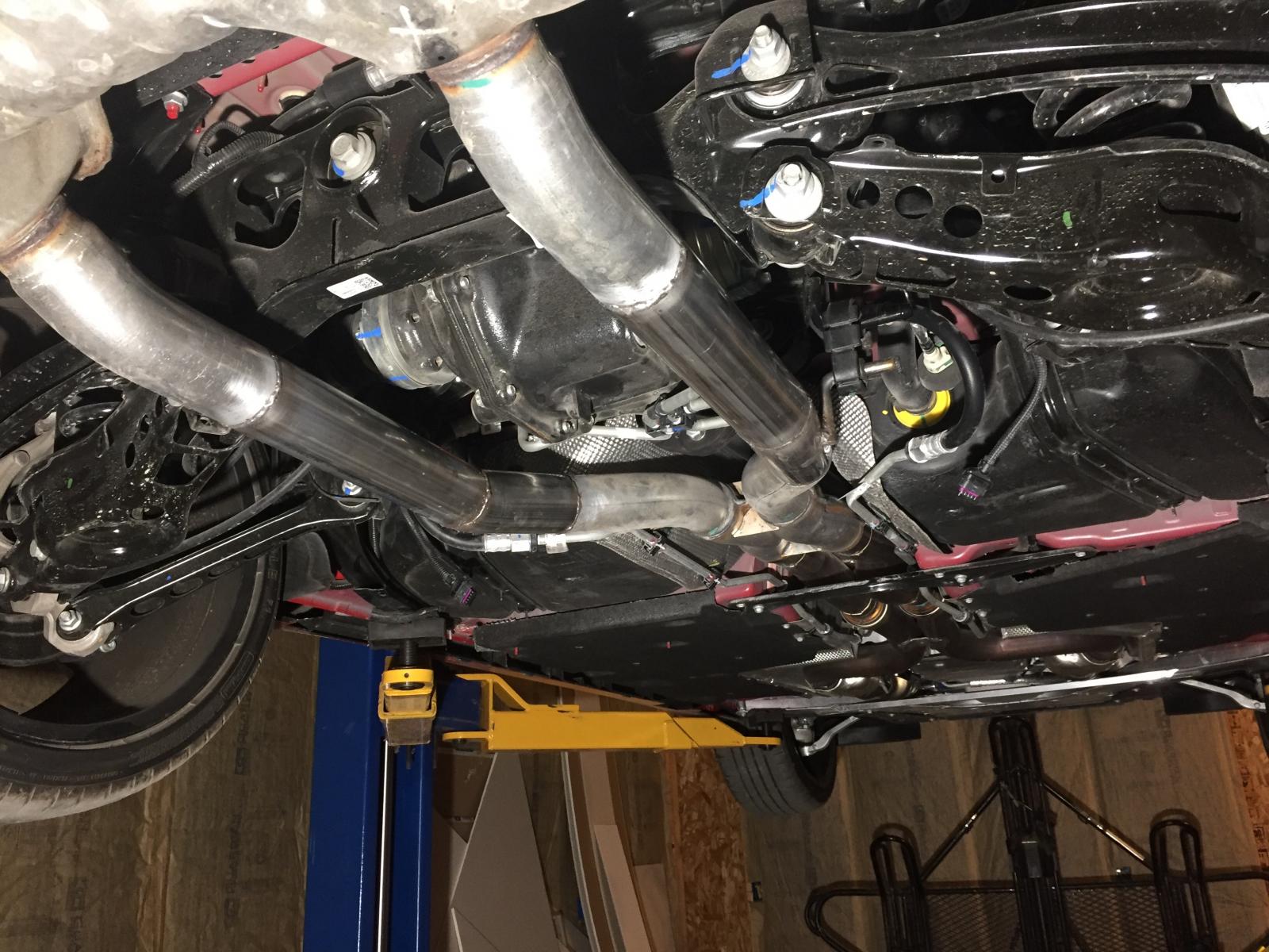

I removed these sections and replaced them with smooth pipe. I doubt there is any hp gain but maybe there will be later when I am making more power. Took about 3 hours and about $70 in material. It might be a hair louder with the cut outs open but I am not sure. You can just barely hear the 4cylinder mode but it is mostly drowned out by wind and tire noise.
Cat delete, e85, tune are next.

I have plans for twins and that crimped area can't help post turbo. I may also pipe the cut out so it completely skips the muffler. Are there any pics of her muffler cut open?
Btw that crimped area is not just squished on the top. It is also squishing on the bottom some and not flat but pushed in some on the top.
I didn't know that about the cel but I figured it was a possiablility. I may dummy the acuators under there.

Do you have a picture of the valve assembly looking into the end of the pipe?
Curious as if they can be fully closed or if the valve was partially cut out?

The valve closes all the way but there is a dime sized hole in the middle of the plate

You can unnbolt the motors, plug them in, and then zip the them off to the side.
