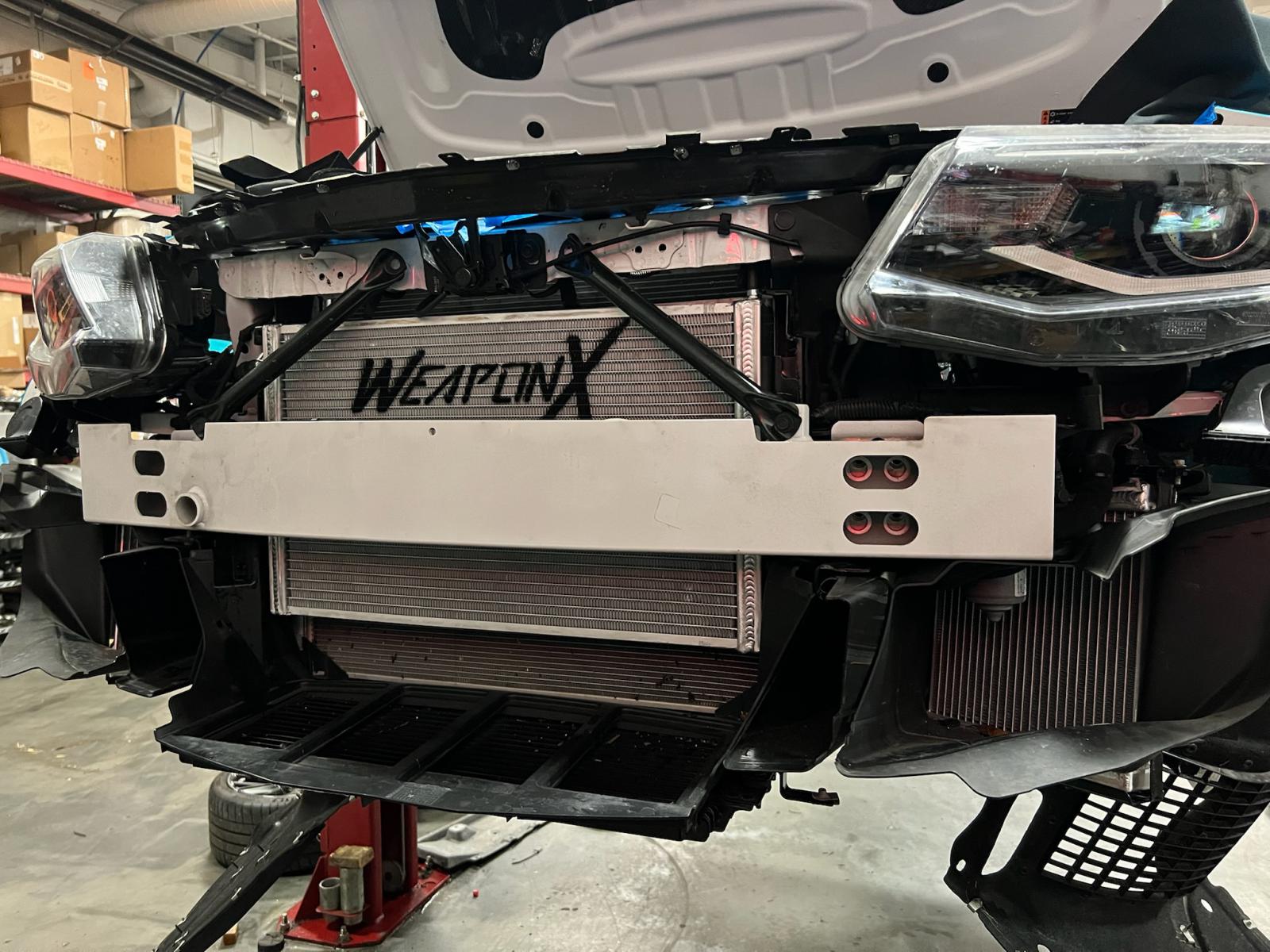

Just finalized the build on my ZL1. Now the wait in line for parts and start of build. What my list is so far, not going to list all the incidental parts. The shop is called Top Speed Cincy and owned by Blake. This is the same shop as WeaponX but, they longer do builds. Blake ran the shop before and decided two years ago to lease the shop and start on his own. He also does all the ECM / TCM tuning, done on a Mustang dyno. See many high end Corvette and Camaro builds going on in shop. Weapon X is still in business at the same location, just not doing builds anymore.

Pic from where the build starts. Only did cosmetic changes the first 3 years of ownership.

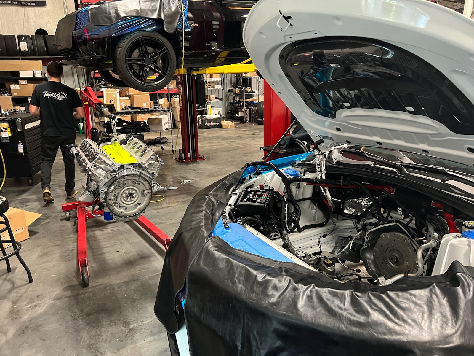

Finally the start of my build, taking the engine out.

More pics of disassembly. Engine has 10 k on it.
