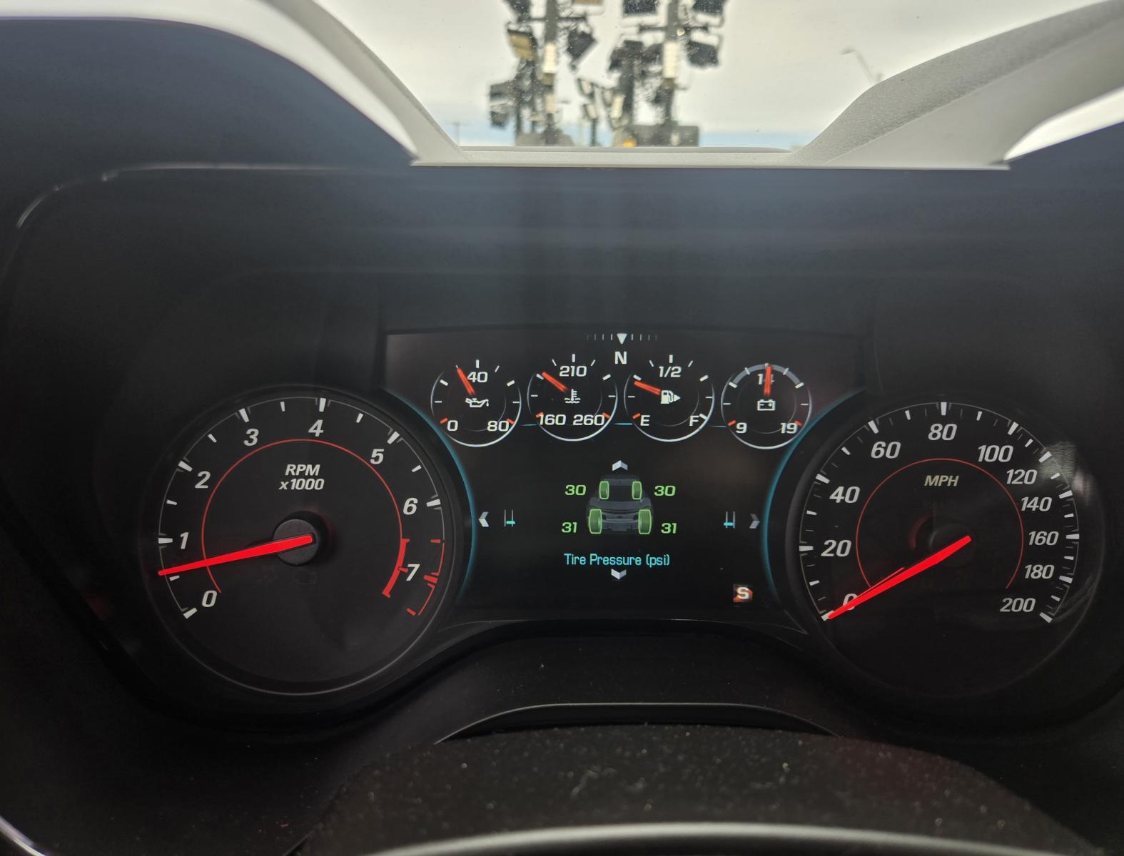

Couple of things I've often wondered.
My coolant gauge never really goes over this spot. Only if it's really hot outside, but even then it still never gets to the middle line. I assume the thermostat was taken out of the engine by the previous owner. Obviously I've never pulled it apart to look, i was just wondering if you guys have similar working areas for coolant temp.

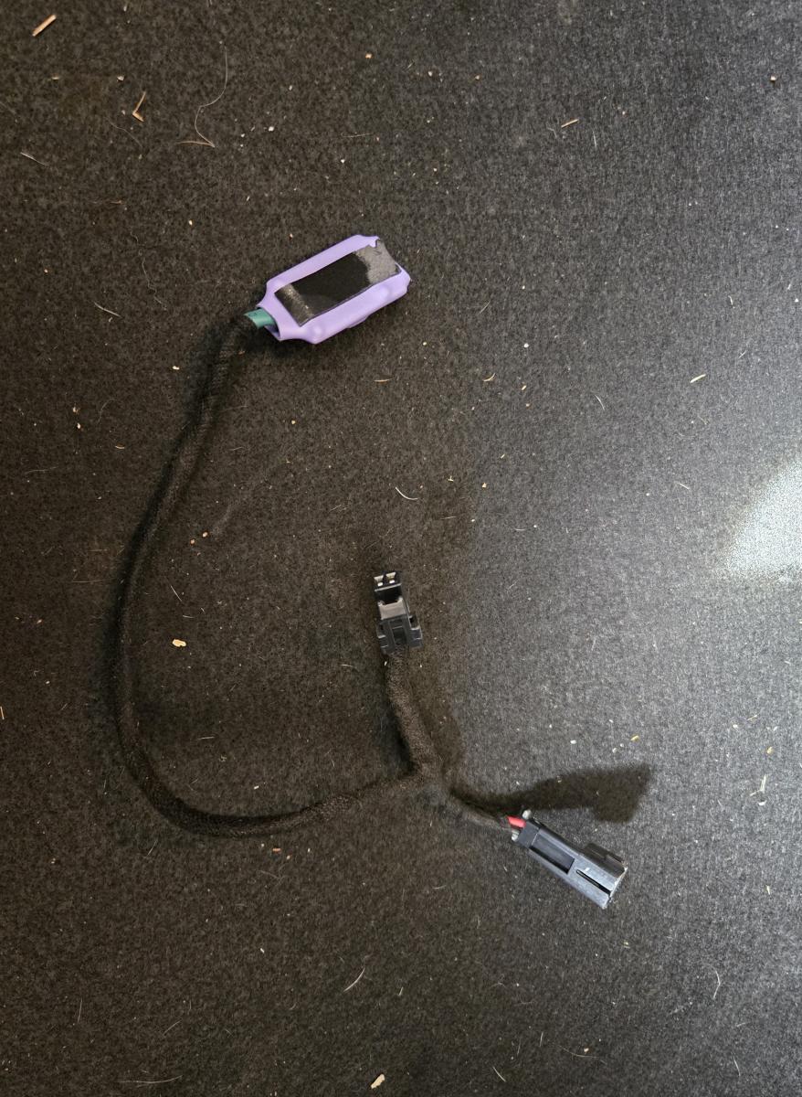

The other thing i wondered was my brake lights will flash twice and then stay on every time i press the brake. Ive never noticed it from other camaros so i didn't know if something has been added or if it's a setting that can be adjusted.

Temp gauge divisions make no sense... 12.5 per tick.

Here is a thread discussing a flashing brake light. The thread has a reference to a NHTSA article that says flashing brake lights are illegal. I suspect that your car has an aftermarket device to flash the lights.

All brake lights flash or just the 3rd brake light?
Usually the 3rd brake light flash is a dealer add-on/aftermarket.
https://www.amazon.com/BlyilyB-12V-2...dp/B0C94VS4PF/
https://wildhammermotorsports.com/16...rness-gen5diy/

Its the 3rd brake light only.
Looks like I'm going to dig into the decklid

Thanks guys. Found this behind the light

As for the temp gauge, so many vehicles I've driven are like this. I more suspicious of my Ford Ranger then my Camaro. That thing just evenly heats up until it get to smack dab in the middle of the gauge, and then just doesn't move, ever. No matter how varied driving conditions can be. The Camaro I can see move up a tick and down a tick from time to time.

As to your temp question:
I think it's not abnormal. The SS has so many coolers for the track that the coolant temp doesn't get that hot just driving around town or highway at low RPM. Mine doesn't get north of 205-210 until I'm on the track with the RPM averaging 4000+ and the oil temp at 260+. Oil doesn't go above 200F until the RPM is sustained near 2000 (driving at 50-55 mph in 5th gear because it's still not quite fast enough for 6th.

I think the coolant temp is normal.
If you didn't have a tstat, or it was stuck open, the coolant may not get to operating temp, unless you're on a road course. You'd see the temp go down noticeably after getting on a freeway due to the increased air through the radiator, especially in the winter. (I had a stuck open tstat on an old beater car and those were the characteristics I noticed.)
