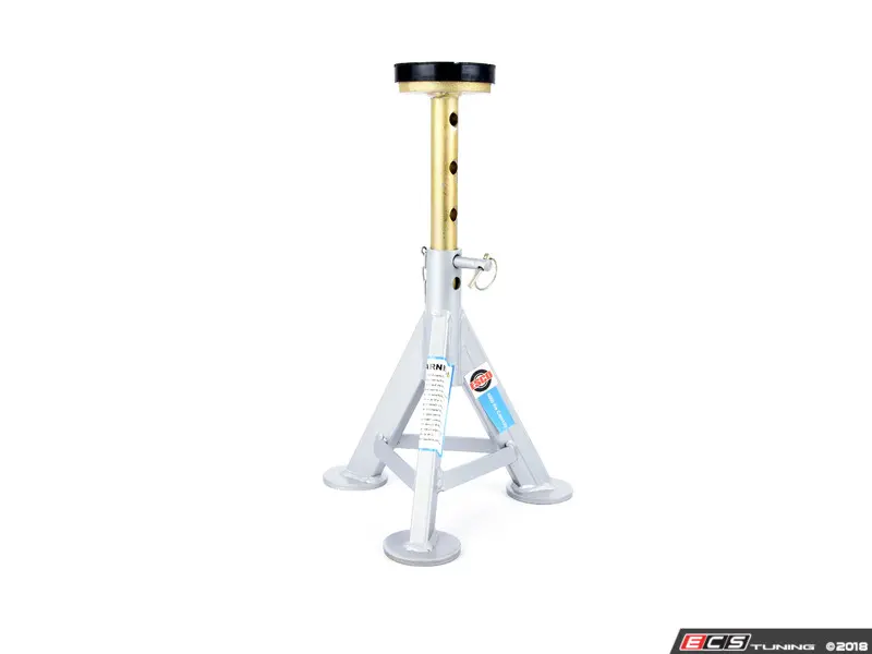

I do it similarly, but have 6 of the lift pads that permanently install on the car with allen-head set screws. I lift with a jack and hockey puck under the middle lift pad point on one side and set that side on the lowest setting of the jack stands. Then I go over to the other side and do the same, but go to my final lift height on that side. Then I go back to the original side and bring it up to the final height. I use these Esco jack stands. I see Harbor Freight has a version of them now, too.

In my case, the only thing that touches a jack or a jack stand are the ZL1 pads shown in my post. I have 6 of them installed in the green circled areas in the picture in your original post.

I think it's a disclaimer for typical jack stands, as I could definitely see them sliding around inside a stand if you are pushing or pulling on the car in any way. With the big rubber pads on mine it's no different than a lift from my perspective, so I'm good with the approach.
It's by far the most stable I've ever thought a car was on jack stands in my experience. I had the same setup on my last Camaro as well, though it was only 4 points and I lifted with a length of 2x4. Anyway, my point is both cars were/are REALLY stable on the lift pads and the large rubber pad on the Esco stands.
Nobody touches my car but me, so if it's getting work done I'm the one putting it in the air. I don't have it on stands all the time, but much more frequently than the average owner I would imagine.

This is what I do, except I have made my own with hockey pucks. I also use the Harbor freight, knock offs of the esco stands posted by RobZL1
