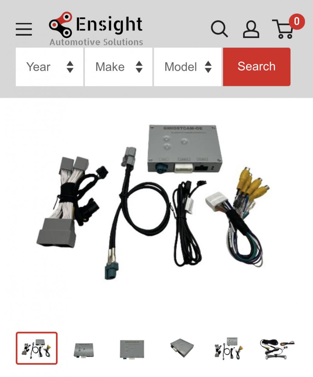

After having a near death experience with my baby and a curb it’s only a matter of time before luck goes against me and I rip up my front splitter
Has anyone retrofitted our Camaros with a front camera??? Or found a decent aftermarket one that works???

https://www.ensightauto.com/collecti...-iot-iou-radio
This is the one I currently have installed. It works good and it’s integrated into your screen.

It comes with the big wide bracket and a little tiny bracket that just fits the size of the camera. I have it two-sided tape to my front plastic. And then I bought some of these cable ties to feed it along up under the fender lip into the cab through the grommet hole going in by the glove box the whole unit is basically installed up underneath the glove box where the radio brain is mounted

It can be activated with certain steering wheel controls depending on the model car and it also comes with a micro activate switch, which is what I am using. I ran it behind my knee pad. Installation is just plug and play but it is a pain in the ass if you’re fat and old like me to get up under the dash on the passenger side. I was tempted to take the seat out for more room but managed to fenagle it. If you notice the picture, I have it pointed just down to the point where you see the very tip of the front edge of the car

What I have realized is it automatically knows when I’m about to park and activates, not sure how but for example if I’m in say grid lock stop and go or any red light traffic stop it doesn’t come on, but every time I’m about to park the cheeky bugger turns on. Quite interesting!

Actually, they’re pretty straightforward “now”, the unit that I got was an older unit and after doing some back-and-forth tech-support they sent me an upgraded unit with far more simple instructions. It’s basically plug and play other than dip switch selection for certain models. I’m very pleased with it, I don’t even have to activate it when I am about to park. You could always contact the tech-support before you purchase just to get a clarity on what’s involved, everybody has different levels of abilities when it comes to mods all be it mechanical or electrical

I got this one too, it’s still $530. I’ve only driven one day with it, but I love it so far. When you shift from reverse, it changes to the front camera until you reach about 10mph. It also changes to front camera when it senses that you’re in a parking lot based on certain inputs (inputs which I haven’t quite figured out yet) and it seems pretty intuitive. Almost every time I’ve thought that I wanted it on, it’s magically read my mind and turned on. It also has a small override switch to hide out of sight to turn it on/off at any time. I had to order a 4-pin molex extension cord for that switch because I can’t run it to my side while out of sight with the current length. I just have it sitting in the glove box temporarily. The automatic mode has been so good that I honestly haven’t needed the switch yet.
There’s a notch in the front bumper that’s almost centered. It locks the camera in place without having to modify anything. I left the camera on the plate bracket that it comes with and zip tied it up above the bumper cover using two of the clips for the grille. It being slightly to one side is no big deal to me, I can still see the splitter. You can’t even see the camera unless you kneel down in front of the car.
