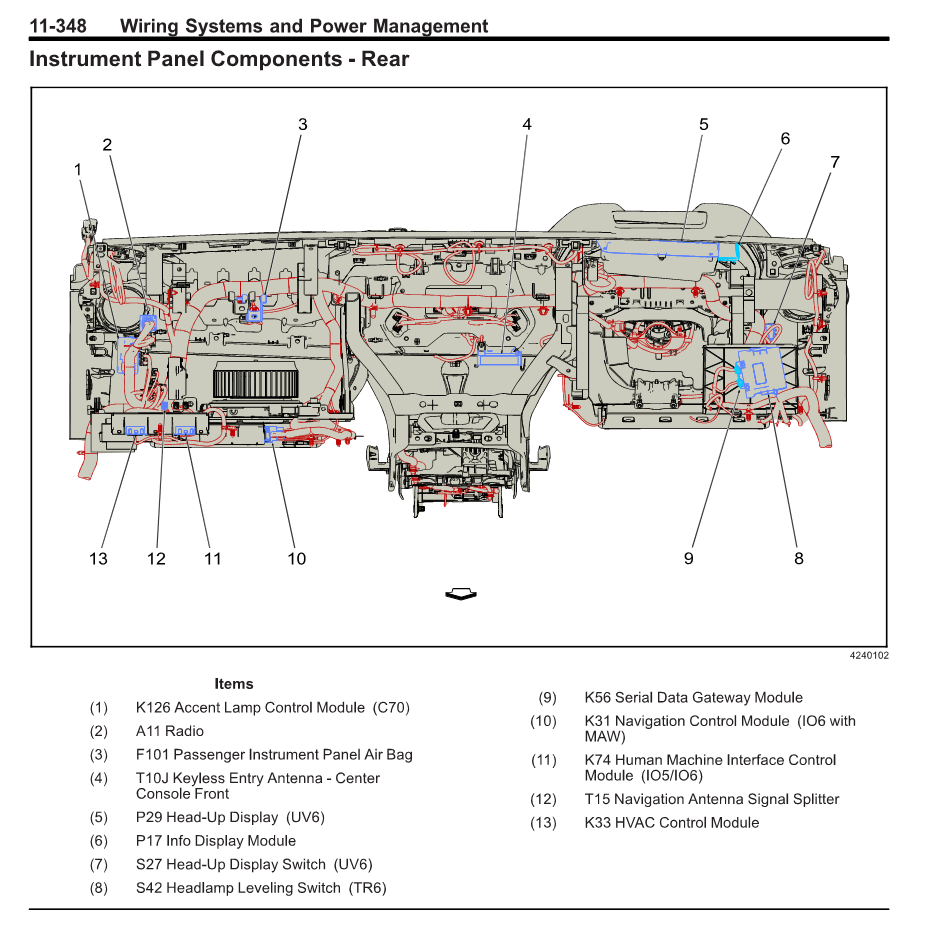

Looking to locate the Serial gateway module on my 2016 camaro 6 does anyone know where it is please

It's module K56 in this diagram (#9).

2016 wouldn't have one that module was added in 2017.
