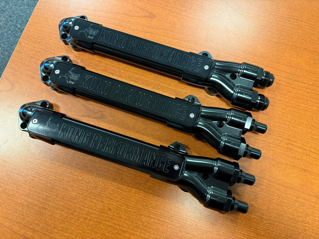

Has anyone tried it? Any info?
https://kongperformance.com/products...vdA1bTvew7Wn_l
With OEM 5/8" quick disconnect or 12AN for multiple water line routing methods, for less than 300$
Thank you

These coolant manifolds are just replacements for the OE manifold. If your blower has been ported by Kong and you are still running the OEM manifold you are not taking full advantage of the increased coolant flow that their ported passages offer. This manifold directly replaces the OEM one and is opened up to match the flow that the ported passages offer. Nothing more, nothing less. You could still run one in stock configuration, but you'll likely get nothing additional from them outside of anodized CNC bling factor, which will lose its dark black coloring in time anyway and turn to a dingy black with brownish coloring to it because that's the way anodized coloring fades over time.

I have one on the way with the dual 3/4" -12an fittings to replace the smaller 5/8" OEM fittings. I had the RM individual port setup with multiple hoses feeding each port and it was a great setup but the fittings are poorly designed, the -10AN fittings are too close together and due to the design, there is not enough clamping load when pushing hard on the track to keep the driver's side from leaking.
I plan to install it even though my SC is stock and not yet ported... I just picked up another LT4 SC and plan to get it ported with sensors to measure actual data not the basic PIDs from the ECU.
If you really want to remove all the air from your system... and increase flow, our system is unmatched!
Thanks, my SC was X-ported by Kong so I suppose it will work better with, isn't it?

Only if it was ported recently. He started porting those water ports this year. Mines has the port I haven’t noticed a big difference, but to be honest I don’t have a before temp to compare. I’m sure It’s not hurting me though. But like one of our Camaro brothers stated without the port it’s just bling.
Correct, so long it was recently ported by kong, as this service was only recently added...
Before he did, and when my blower was off the car 2 years ago, I had hand ported those passage ways also, just not to the extent KONG did. Even with that porting in place, once I removed the restrictive OEM crossover tune, and added what is now our GMS Crossover Delete Package, I was surprised to see a 20% increase in GPM flow. Likely even more now that we have the manifolds ported to match the 20% larger water jacket circumference curtesy of KONG.
That said, and without testing the KONG crossover tube, I would assume at least a 10% increase in GPM flow... assuming less, as it is still not a dedicated in/out system.
I agree, it looks great, should flow more especially when paired with his new port work.
Also know, that KONG will upgrade from his older X-port to the newer X-port for around $1,200 +/-
In short, there seems to be (2) options for addressing the OEM crossover tube restriction to date. Both work, both look great, so it's really about which you prefer... I think the KONG unit is going to sell well, and is a great addition to the aftermarket options.
