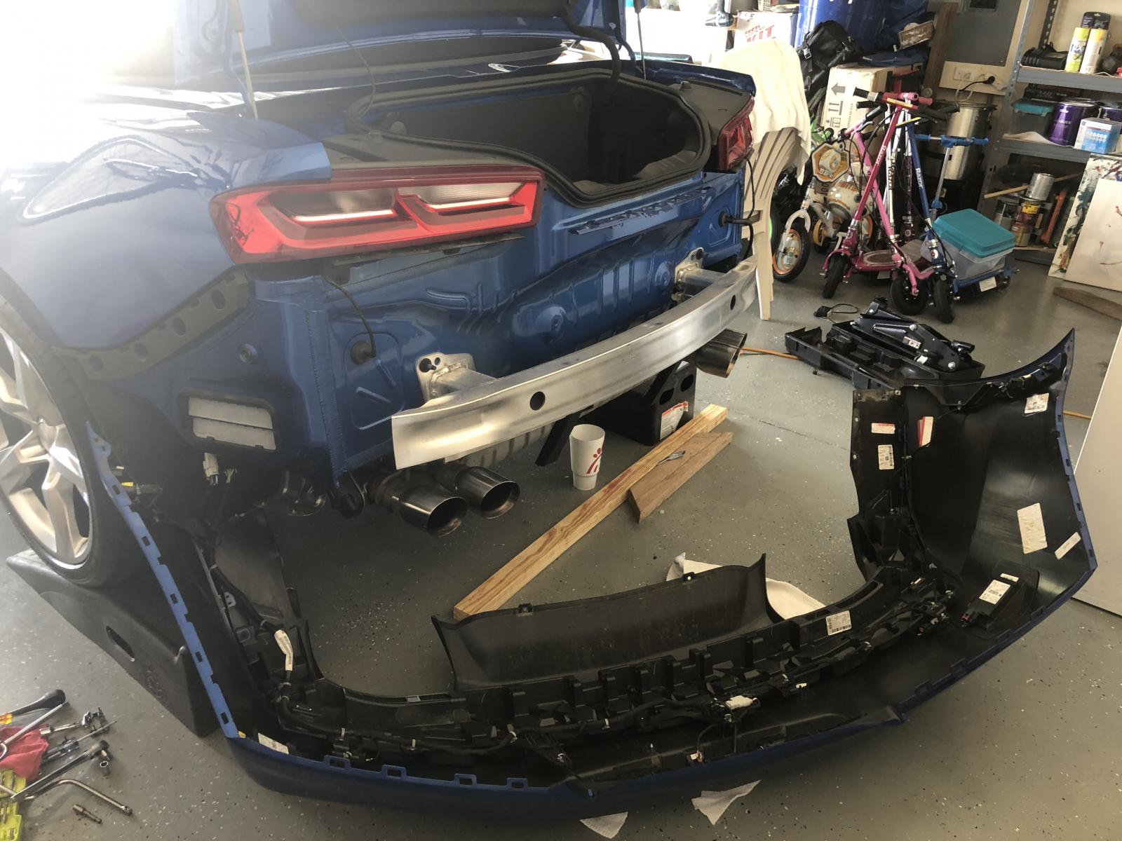

I added a hitch to my new vert last night. Not a bad install at all. I have done many of them.
A few hints:
*remove the lights first before the bumper cover.
*cut the new T-connector wires and run them thru the grommet, not the entire new plugs that go into the taillight as instructed.
*My left taillight was very hard to remove. I removed the 3 nuts holding it on but I had to pull VERY hard to remove it.

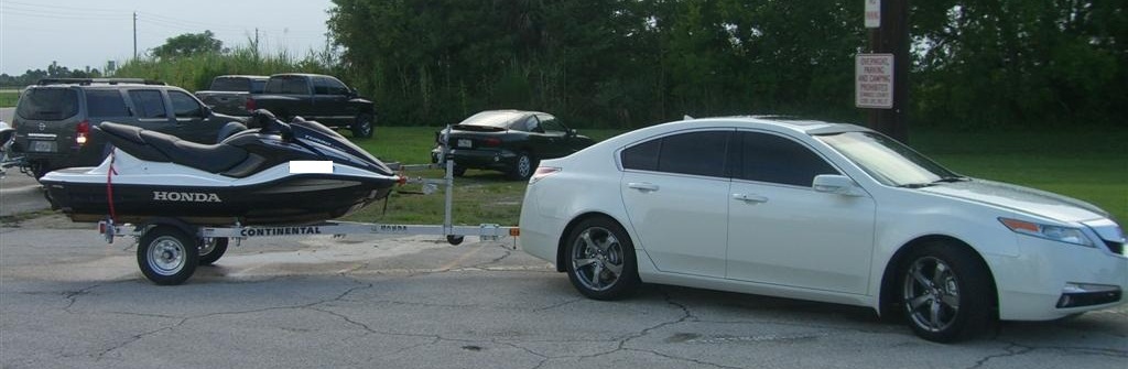

Don't bash me for a hitch. I jet ski a lot and have a truck but sometimes just taking the fun car is more enjoyable. I have always used cars to tow with zero issues.
Some pics of my last cars with hitches.

Sweet fifty.. yes all hitches get sandwiched between the aluminum bumper and the car. So removing the bumper cover is standard.

Cutting required ? It's not specifically called out on their install instructions.

No cutting at all.
