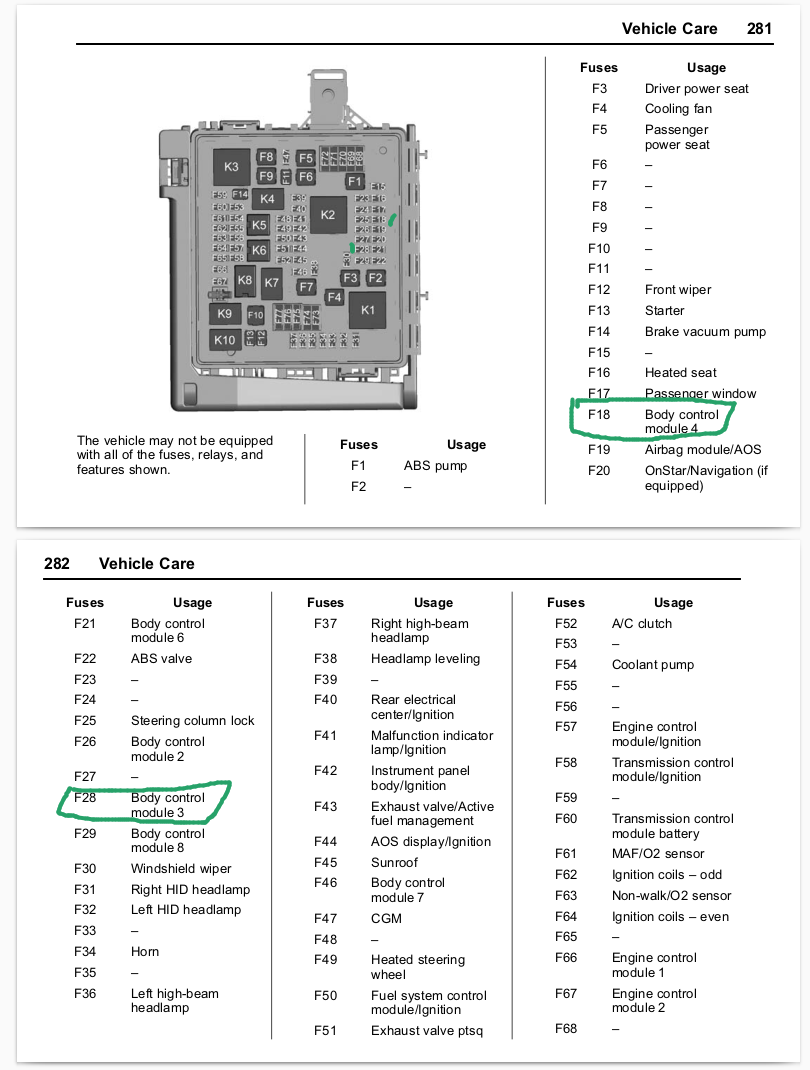

Hey CamaroChill, try the suggestion above, LEDs are polarity sensitive (being diodes, they only conduct electricity in one direction), and especially cheaper parts don't have built-in electronics to reverse the wrong polarity for you automatically. Very easy to try, just plug it in the other way.
If this doesn't fix the issue, try swapping the bulbs side to side to see if it's the bulb or the car. If it's the car, try putting the stock bulb back in to see if the LED part blew a fuse.
If the stock bulb still works, you have a problem with the product; furthermore, if the LED bulb works on one side but not the other, toss it in the garbage and buy Diode Dynamics or Oracle or something reputable instead. (For the record, I bought this unit from JW Motorsports in May 2019 after repeated issues with Diode Dynamics, and all four of my JWM side markers have been working flawlessly since then. Rumor has it that Diode Dynamics have since then fixed the problems with their suppliers and later units do not die like mine did several times.)
The fuses to check for side marker operation are F18 (body control module 4) and F28 (body control module 3) in the underhood fuse box.

Possibly, you need to check the underhood fuse box. I posted a picture above that I marked up the fuses in.
The good news is that you will find both a fuse puller (looks like small plastic pincers) as well as a row of spare fuses in the fuse box, in positions F68 to F72. See if the ones I indicated are blown, which you can tell by pulling the fuse, looking through it and seeing a burnt or at least no longer continuous metal line within. If that's what happened, pick a spare fuse that has the same amperage (also color). For the record and to help your future purchase, our cars use Micro2 ATR fuses.
With that said, if the LED bulb burnt out a fuse, it's defective, so replacing the fuse and plugging the thing back in will just result in another burnt fuse, I would put the stock bulb back in, and if it works, buy a better side marker.
If these fuses are intact, check the connector and the wiring on the side that doesn't work now.

I’m here working on the car and the fuses in F18 and F28 look good, I even tried replacing them but the front left side marker light still doesn’t turn on unfortunately
