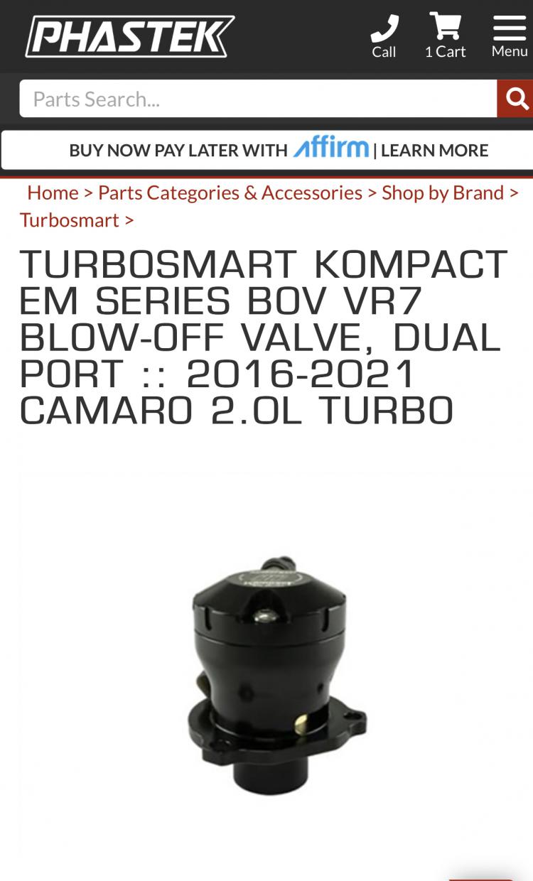

Is this the one you are talking about Dave? Cause this is the one I have. Phastek has a video on installing this in a Camaro 2.0t so I can’t understand why they would do that if it doesn’t work on the LTG

Yup the dual port one. Not a single problem. It flutters at low rpm and a loud psssshhht after boost builds.

After having this BOV, the dual port version, it completely messed up my engines air flow and was almost acting like a transmission problem. Maybe it’s alright with it being tuned but DO NOT PUT TGE TURBOSMART DUAL PORT BOV ON A 21’ 2.0T CAMARO.

That's not good it's doing it to yours. Mine never had that problem before. Sorry to hear that. I'll let you know if mine starts acting weird, but had it on for 8 months and not a single issue.

Dave, did you install plumb-back or vented?
Sounds like Cyrkle initially installed vented, and we are recommending he reinstall in the plumb-back configuration.

I installed the exact one above from phastek. Installed it, and never had an issue from it. There's a 1/4" tube to pull vacuum and a sensor connector. Made sure to use oem gasket and not a single issue.
