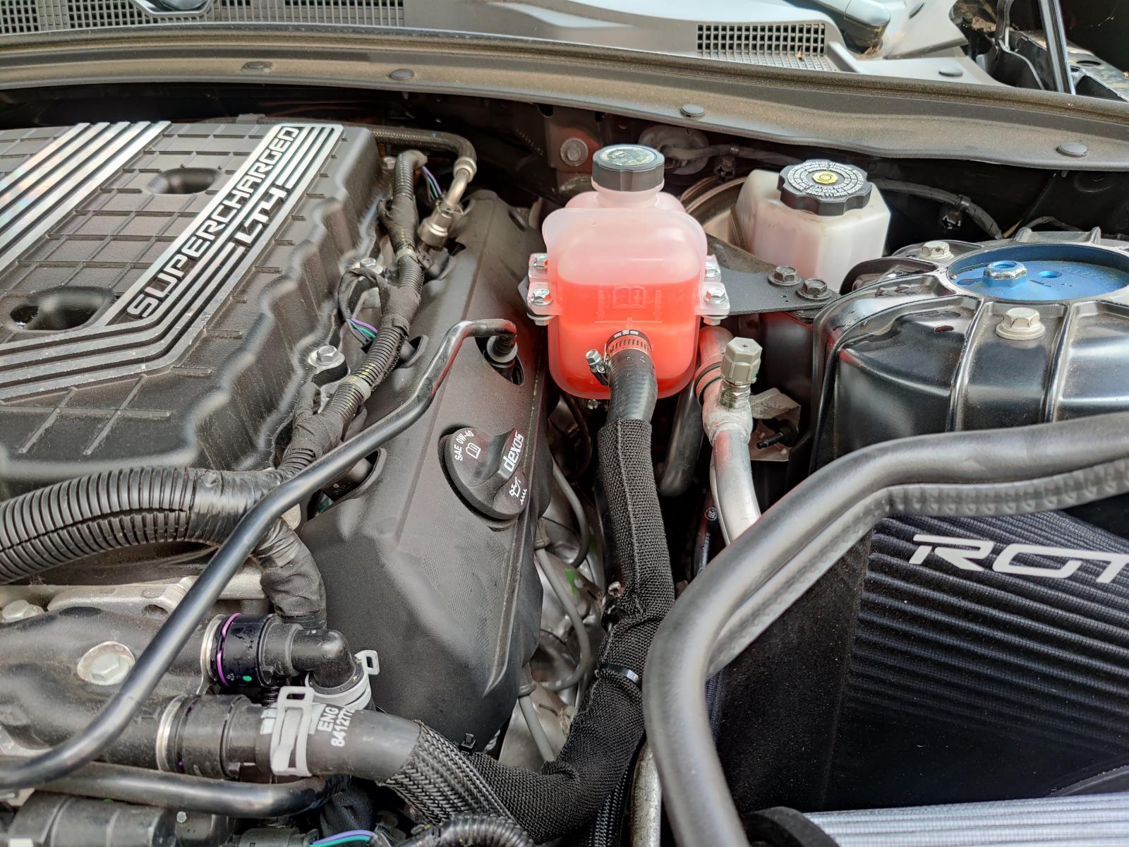

One more thing, since you track this car and need all the cooling help you can get given how these blowers heat soak quick, I would run an external low temp radiator coolant tank of some sort for the blower. It's not a "go" mod, but more of a supporting mod for the system as whole.
I have the ADM Intercooler Reservoir v2, however, I don't believe it provides any additional cooling. I purchased it to ensure I never have air in the IC system.
The additional coolant provides reserve volume for the system. It is to help for air in the system indeed, but it does have additional side benefits. Additionally I would also consider switching to water wetter/ engine ice, as water has better heat displacement benefits over ethylene glycol coolant, the boiling point of water is lower than coolant, however, making it difficult for full on water to operate properly in cooling systems. That plus it's inability to prevent corrosion and that's where the water wetter/ engine ice comes in.

2) I also got the SC coolant circuit reservoir as I think there was some engine management kicking in that was fouling the system.
