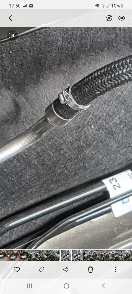

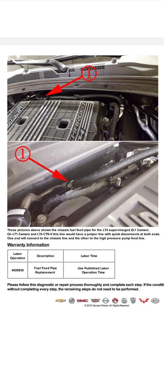

I plan to replace the factory check valve with the one from Lingenfelter. If I cut the crimped, braided hose from the hardline, is is it possible to use a quick connect fitting on the hardline? Is there already a bulge on the hardline that accepts a quick connect female fitting?

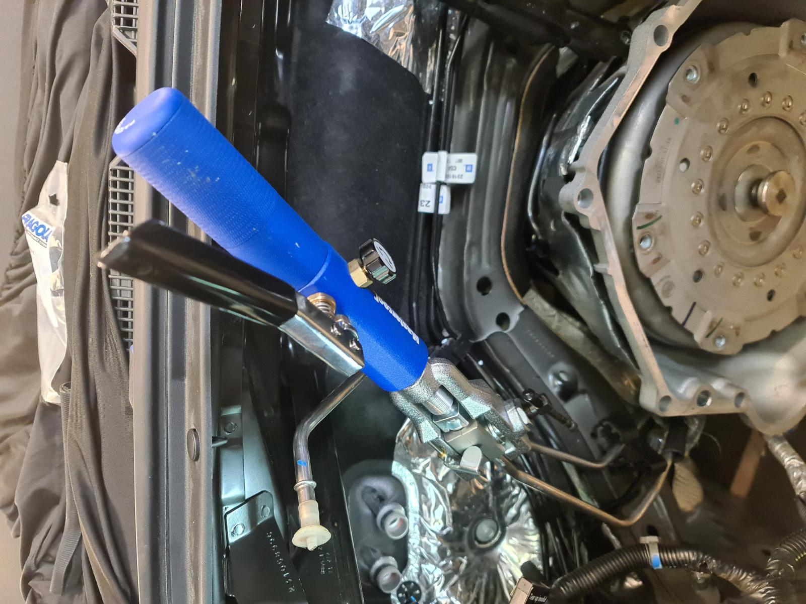

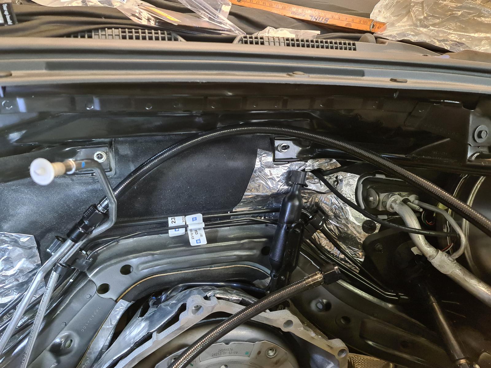

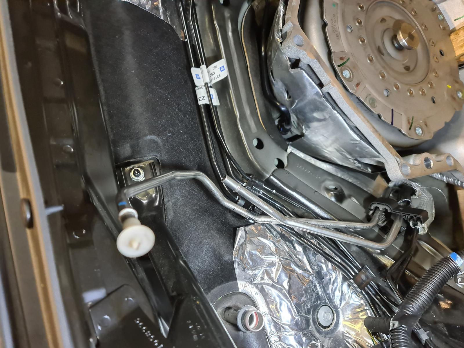

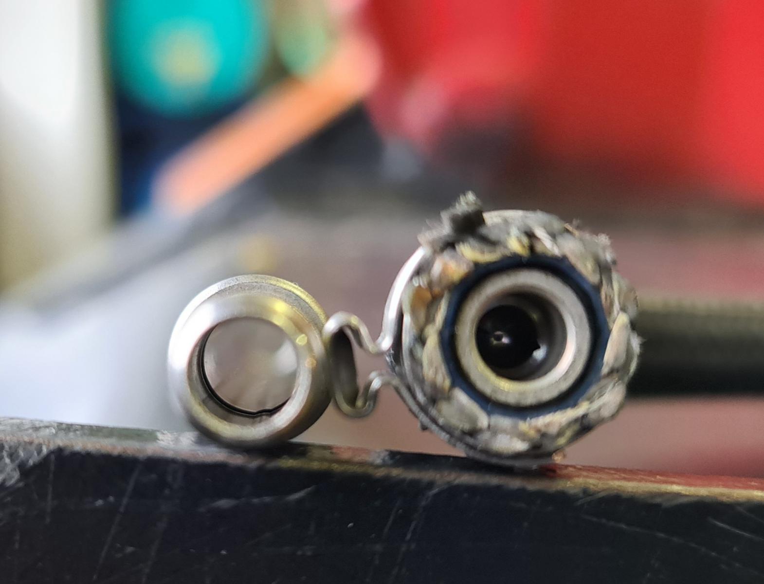

Yes, there is a bulge on the hardline, but it is not safe with just a new hose clamp, and to short for a quick connect. I ended up cutting the hardline and making a new quick connect flare with a flaring tool.
Or you could also just use a AN hardline adapter like this one. (No flare tool needed) https://www.summitracing.com/parts/EAR-AT165086ERL

Yes it works.
I only have the part number from my link in my post above.
& I used some of those AN quick connect adapters
https://www.summitracing.com/search/...-quick-connect

Hey Swiss, is this the crimp tool you used? It sure looks the same.
https://www.amazon.com/MASTERCOOL-72...s%2C431&sr=8-1
Yes that is the one. I suggest to make some test crimps first on an old line, to get the feel for it. If I remember correctly you have to use the 3/8 quick connect die set, not the 3/8 GM, that is the old style.
