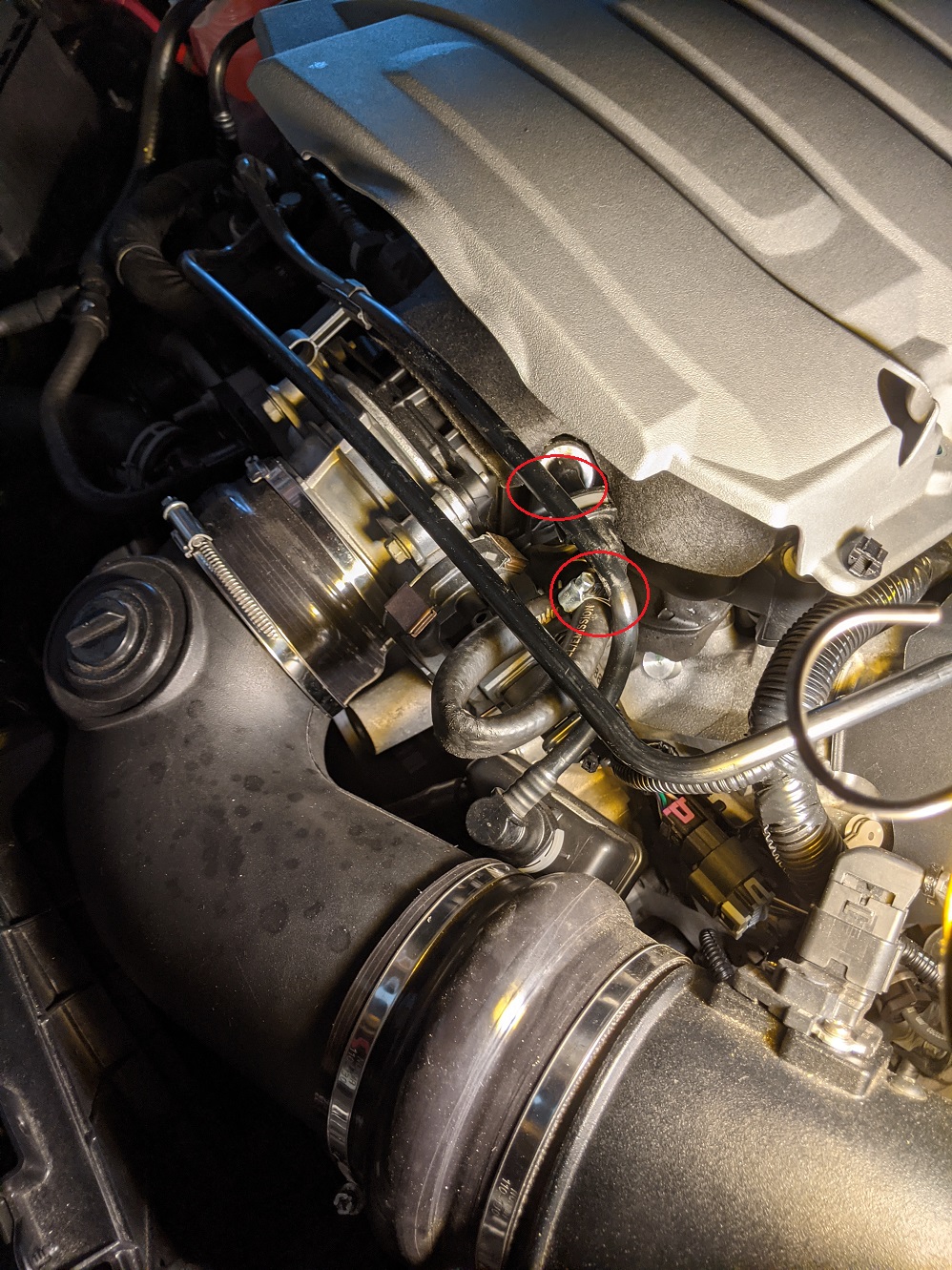

I need some help with a stock part number if anyone knows. I tried fitting the LT2 IM but did not like how tall it was. So I went back to stock for now. To make the LT2 IM work i hacked up the top right sensor assembly. The sensor attaches in 2 places with the second connection right below the upper. You can see the red circles marking the spot. Theangle is too steep for the bend. For now I just want to put the stock sensor back in and worry about the hookup later.
Could this be part Oxygen Sensor
12655677
Upper Oxygen Sensor, Right?
Corvette. Upper. Camaro. 6.2l. CTS. 6.2l. Canister & sensors, 6.2l.
Also I am wondering if there is a clean way to anchor the cylinder wire bundle without ziptying them back to the under cover.
Thanks.

Looks to me like you hacked up the crankcase ventilation hose. That upper red circle is where the crankcase vent hose goes onto the intake manifold. Not an oxygen sensor that I see. BTW that sharp bend in the rubber hose is not good for flow, should be fixed.

Dump the cover. It will never fit right.
Look here for the hose. Look here #38.

Here is the part number that is on the stock pcv tube from my 2017 SS:
12629757

And yea the crimp is not good, but right now not driving it much. Awaiting my Nitto 1LE tire setup. I sold my DRs so I am back on all season run flats.

I found the part: GM12629757.
