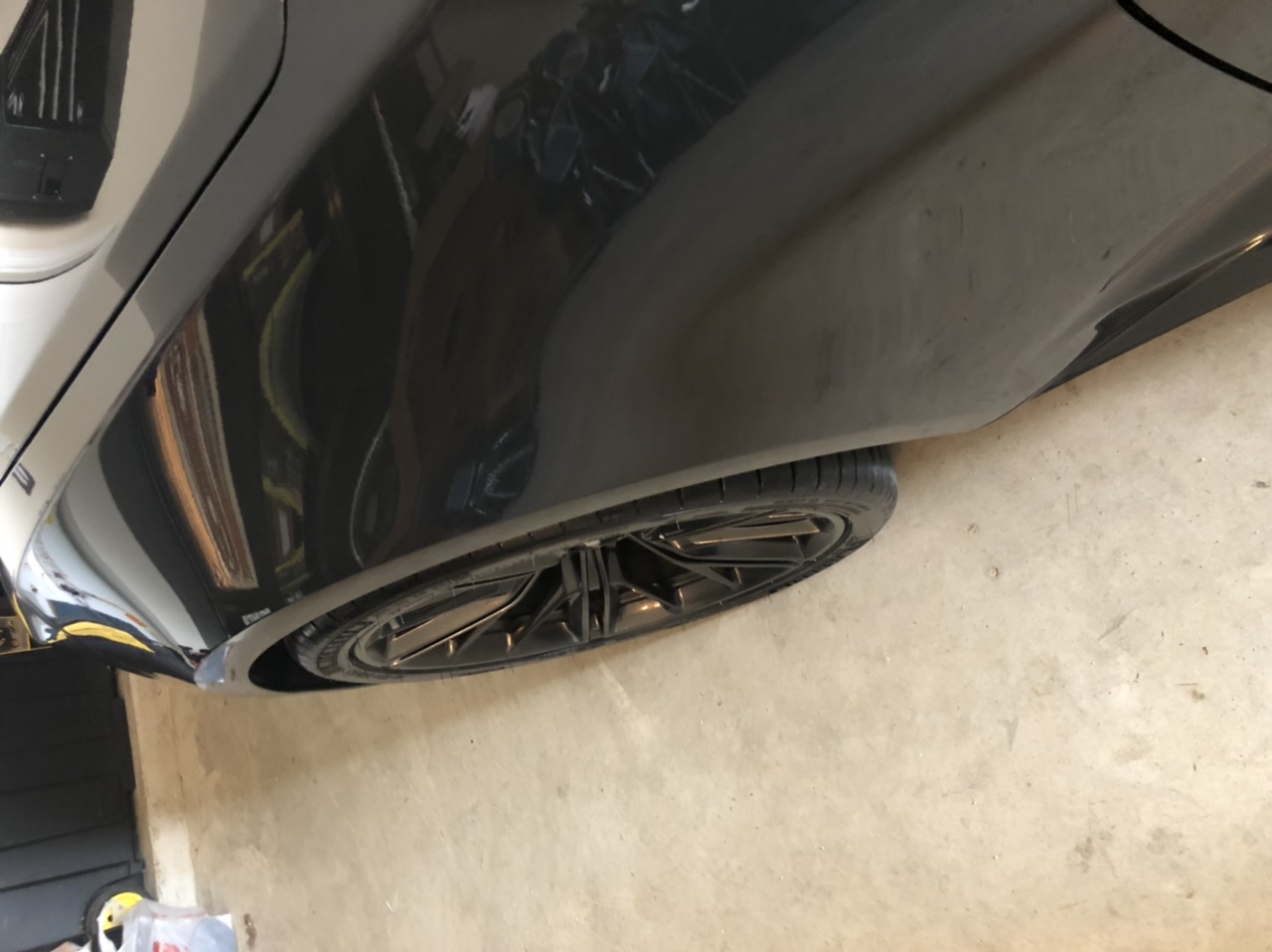

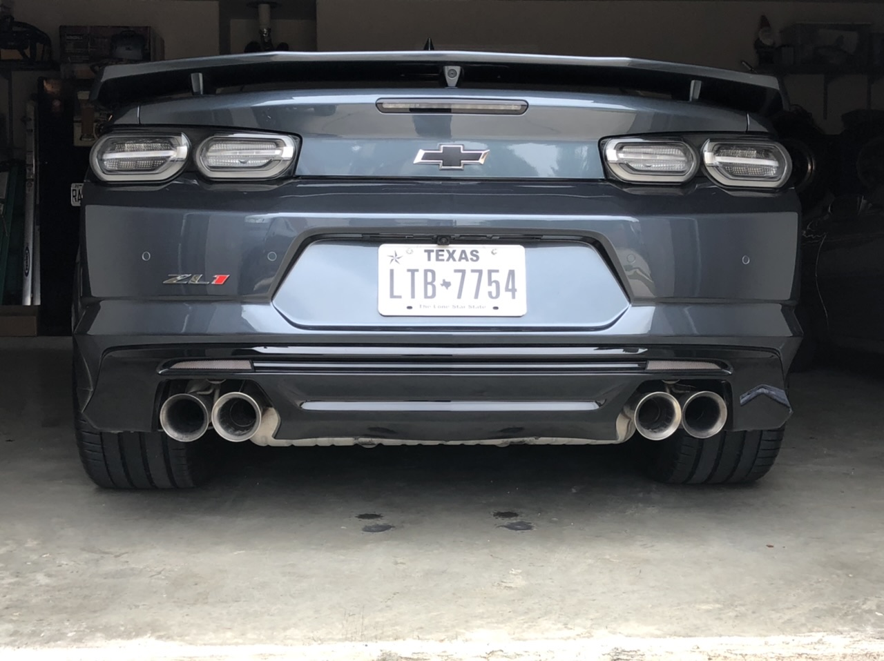

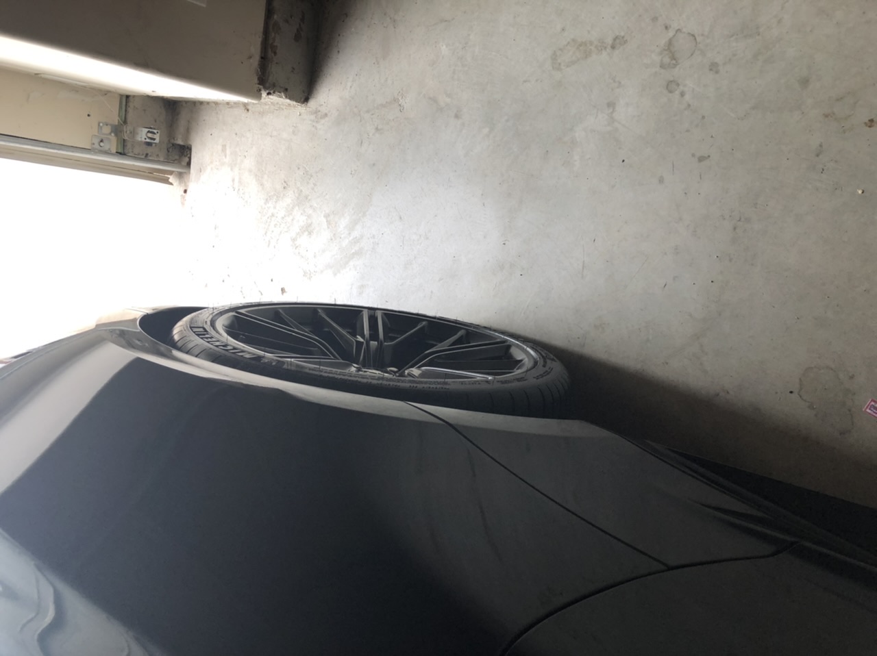

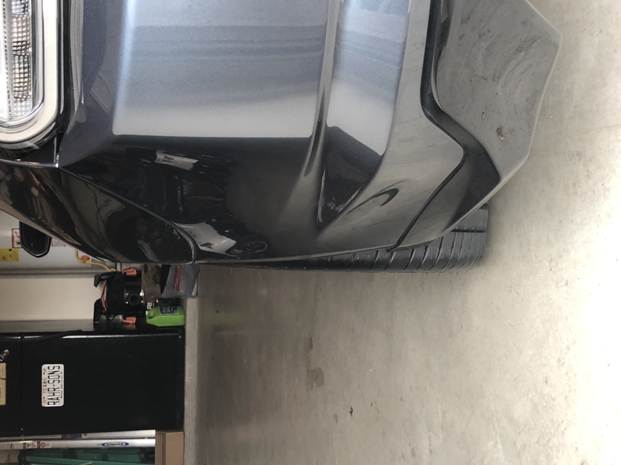

Can you put a side view picture?
pizokk1 is offline   Reply With Quote
Old 04-28-2020, 11:39 PM   #11
Bain
Drives: 2019 Shadow Gray Metallic ZL1
Join Date: Jan 2019
Location: Fort Worth, TX
Posts: 57
Here you go.
Bain is offline   Reply With Quote

What is up with my pictures posting sideways?

Can anyone fix my pictures?

Car looks great...even sideways!
Any rubbing issues with the front 295s?
