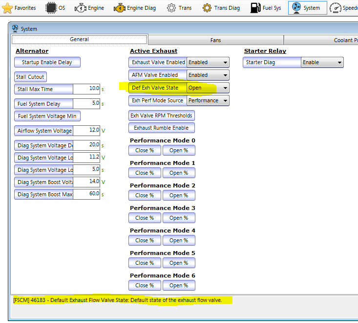

The one you're looking for is #51 in the engine bay fuse box.
I don't think you can force the valves closed at all times without a tune, pulling the fuse will keep them in their default state, which is open.
That said, I do recall seeing an option in the tune to change the default state, which is interesting, because I thought the valves had a spring-loaded mechanical part that pulls them back to opened. I don't know how a "closed" default setting could be maintained without constant power.
EDIT: there it is. Maybe I was wrong about the mechanics of the valve assembly.
I don't see that option being available FYI in HP Tuners latest beta with my ZL1
