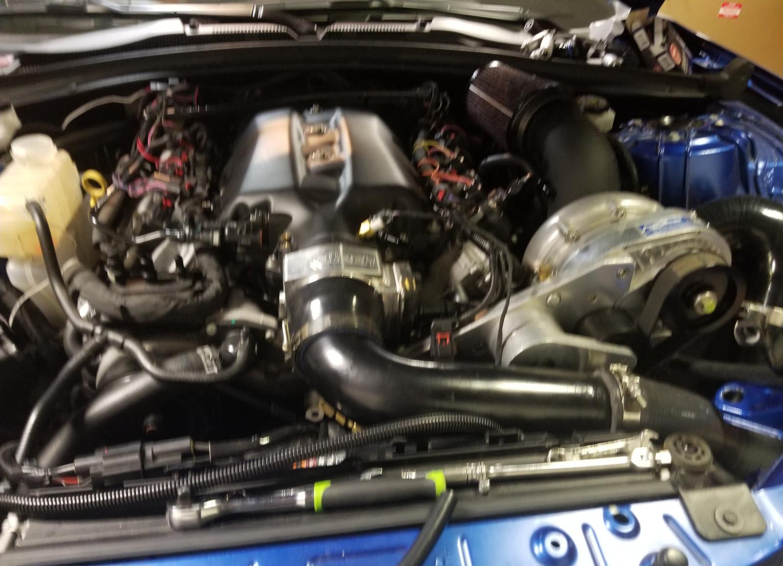

I got an different silicone reducer from lil john motorsports. What size tube is your charge pipe? 3" or 3.5"?
If you are going to the 3.5" procharger race pipe, I used this. It's a tight fit though.
https://liljohnsmotorsports.com/btr-...r-coupler.html
2016 1SS A8: FBO + Circle D + P1X + Meth + Tuned by Pray Performance

I thinks it’s the 3.0 I will need to measure it. P1X systems if it matters. Ant pics of yours ?

Here
