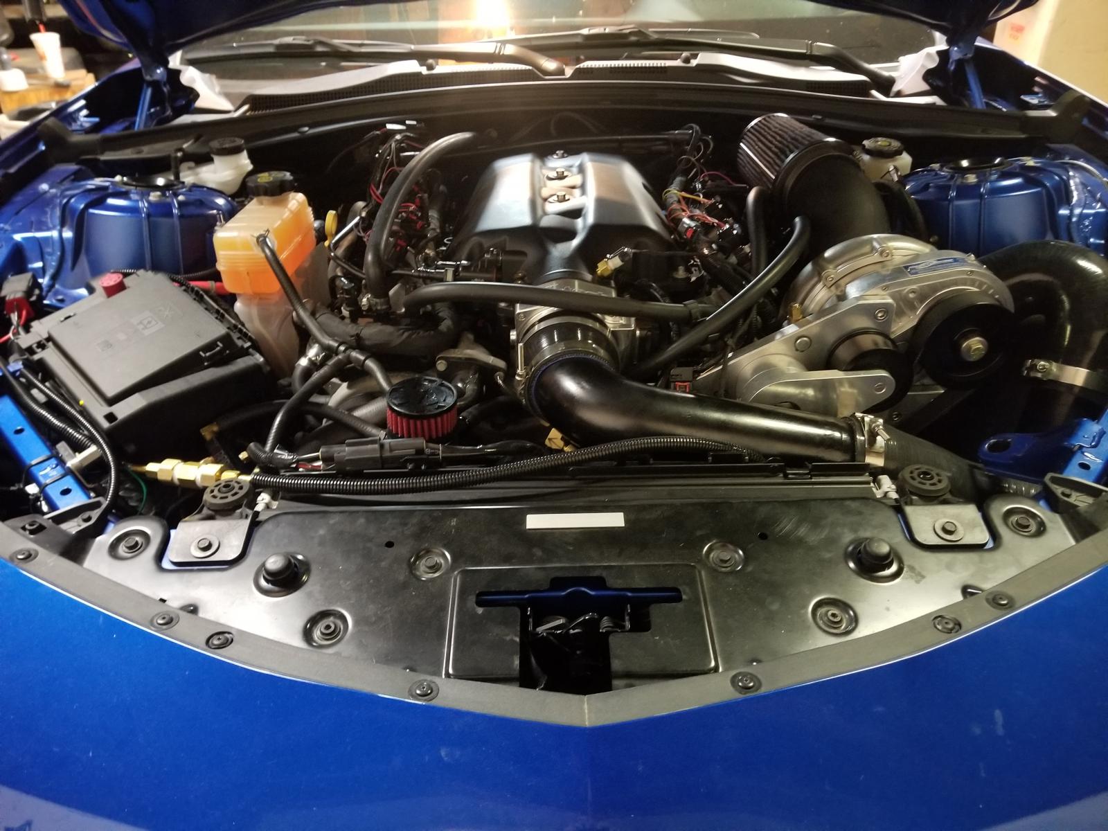

The car was FBO, with the intention of going with a max effort H/C. But I found a sweet deal on a p1x kit and decided to do something different. Which is why some of the mods are a little..... unorthodox for a centri build.
Mod list:
P1X with stage 2 intercooler (with 3.7 pulley)
Ported MSD intake
Katech 103mm throttle body
Kooks 2" headers
Alky control single nozzle meth kit
Lt4 low/high/injectors
ATI underdrive pulley
Pray performance Circle D converter
Pray Performance ECM/TCM tuning
QA1 driveshaft
15" rear conversion
Aerospace front brakes
Bogart drag pack with 28" M/T PBRs
DSX IAT/Baro breakout
The usual weight reduction (3600 lbs raceweight)

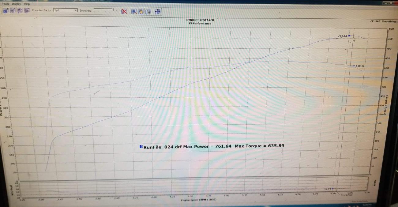

The car put down a healthy 761 rwhp on 93/meth(SAE on a dyno jet. My car base lined 390 rwhp on the exact same dyno).
