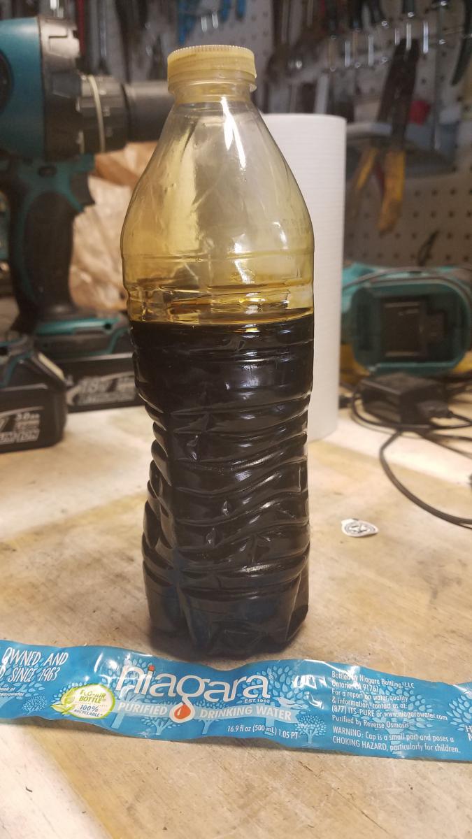

I have 31,700 miles on Camaro SS A8 and this is the amount of oil I have prevented from entering my intake manifold.
mishimoto catch cans

...and the vast majority of that oil would have been combusted. A small amount would have stuck on the valves and intakes. Likely no performance deficit and just needs to be cleaned once in about 10-15 years if you care enough.

is this the catch can that adds vacuum to the egr line or is it just inline with egr tube going to the intake?
I'd be less worried about how much oil it's catching and just grade performance of the catch can on how much oil residue is coating the throttle body and upper intake area that you can easily reach and check.
No oil/gunk == good. The catch can is either working or doesn't have anything to catch in the first place.
Some oil gunk but lots in the catch can .... This is a red flag, you shouldn't be sucking oil into the egr to a significant degree and this is where additional vacuum could be hurting you more than any hypothetical help it is providing. If no vacuum, then other mechanical issues could be at fault.
some oil gunk but not much in the catch can ... catch can is not performing it's job.
Lots of oil and gunk ....problem. Hope you didn't do anything to get the dealer to try and void your warranty.

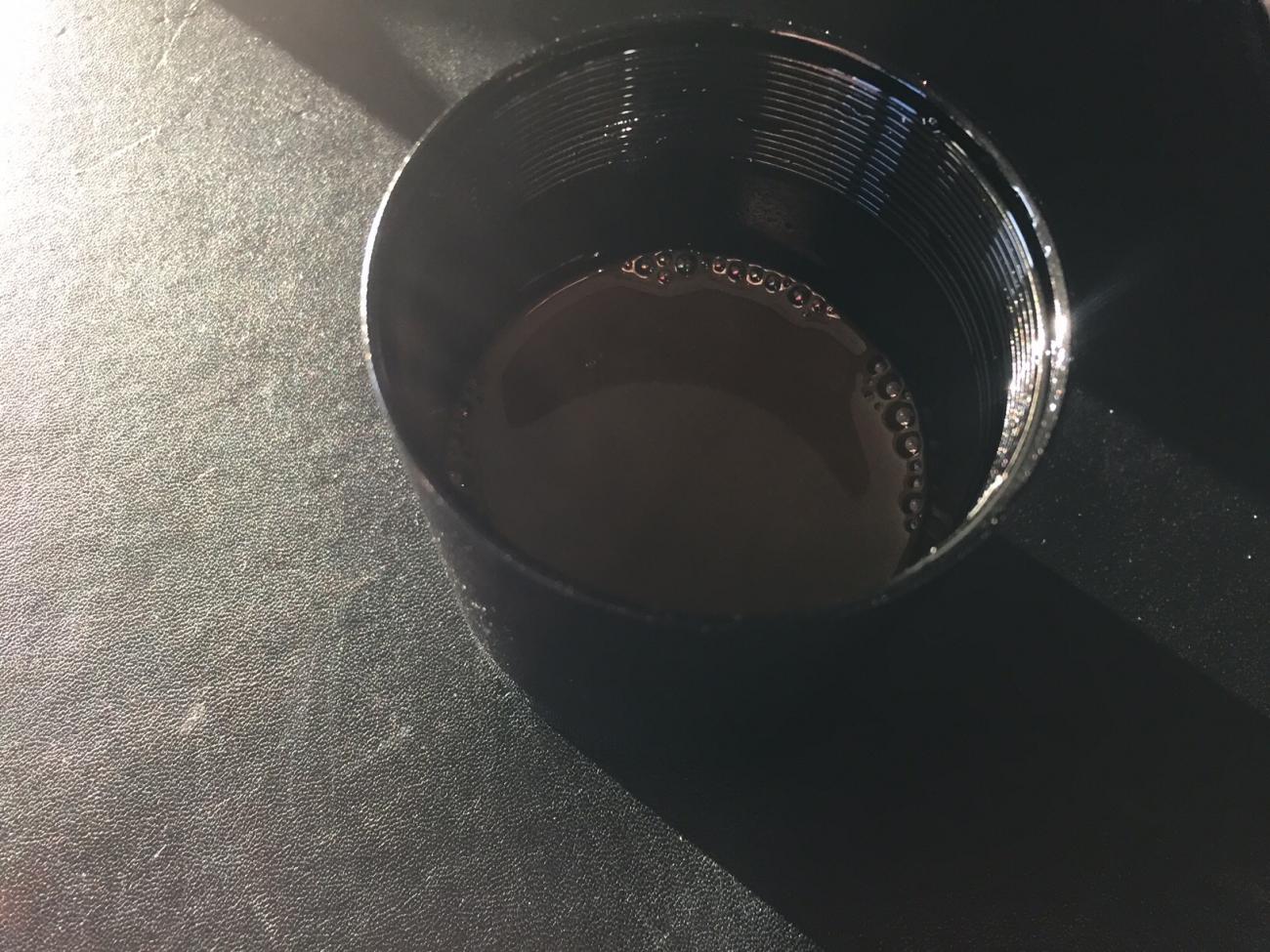

A catch can has the potential to block the crank case ventilation causing it not to function properly. That happens if the owner fails to maintain the can, or in cold climates, when the can fills to the top with water in only a few days.
If the crankcase is not adequately ventilated, blow by gases will condensate and the motor oil will quickly become contaminated.
That happened to me in the first winter with my 2016. In a matter of days the can filled with water and blocked the crankcase ventilation. The drain oil was so badly contaminated that when I changed it in my closed garage (winter), the air reeked like gasoline and my eyes burned. The oil had only been in the car 1,500 miles.

Good for you. I did.
