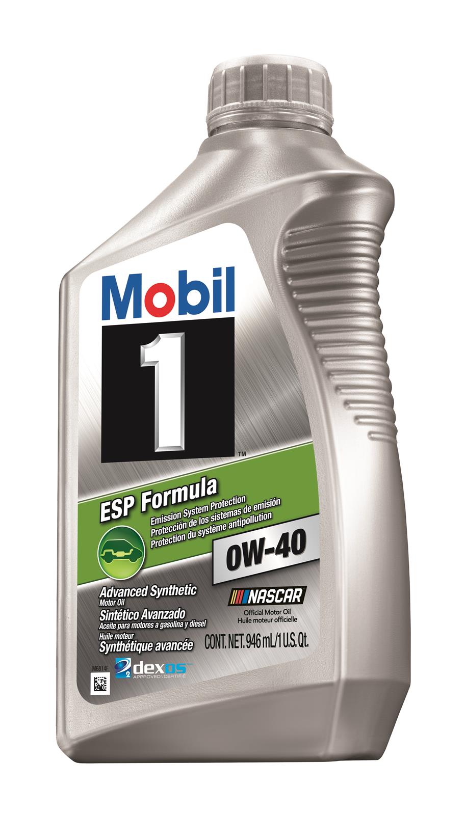

The factory fill is Mobil 1 0W-40 ESP Formula (it is Dexos 2 certified (blue Dexos logo))

15W50 Mobil 1 is still recommend for track duty. I would not (and don’t) run 0W40 for track duty. I always change oil before and after track days. Mobile 1 ESP oils were specifically developed for emissions system protection.
15W50 is not available in Dexos2 BTW.

Sure, I'm just saying Mobil advertises this capability, see below (they mention the C7 with both the LT1 and the LT4 later). High temperature viscosity of this oil must be better if they are willing to claim "track to street", even if the focus was clearly on emissions.
https://mobiloil.com/~/media/amer/us...ne%20pager.pdf
