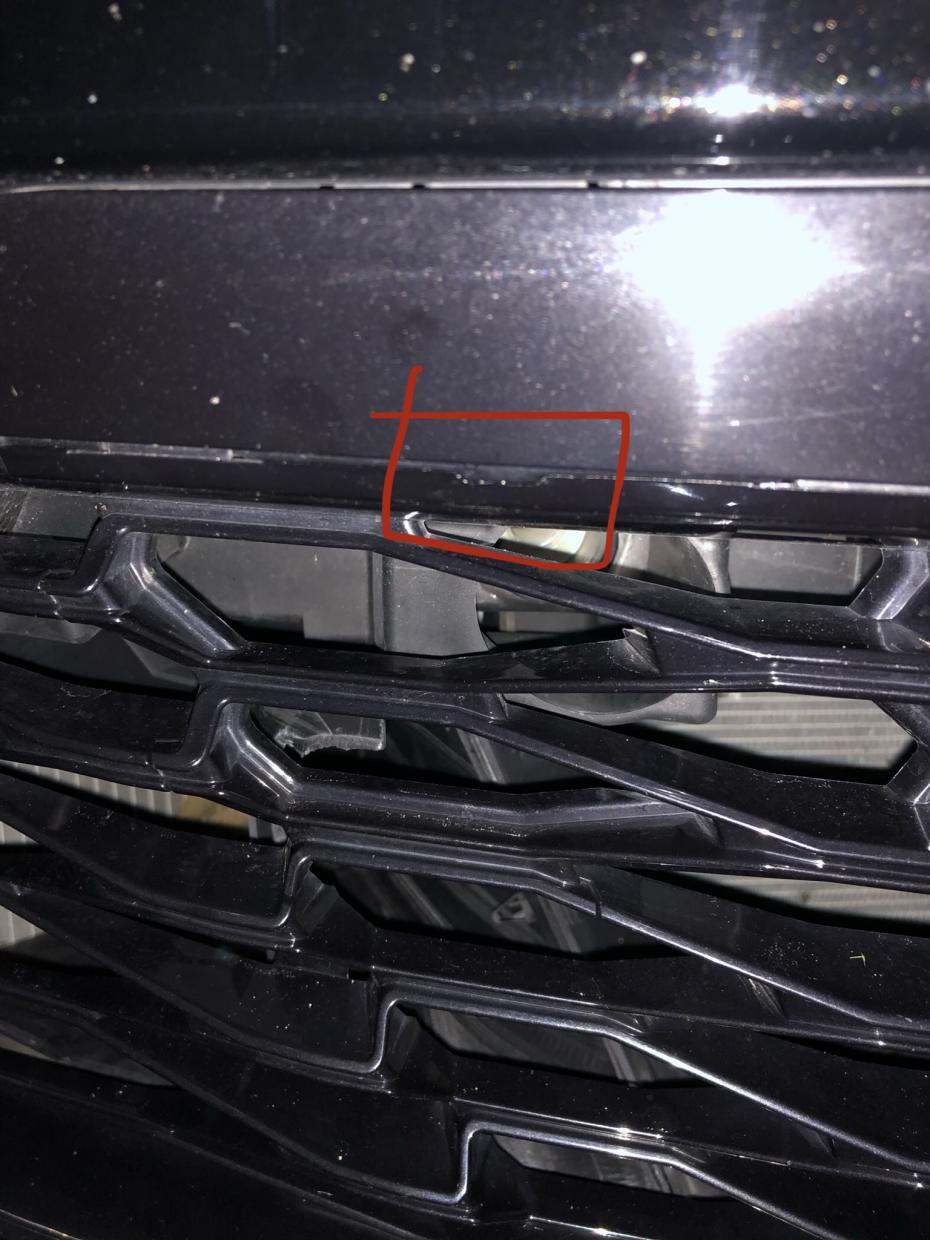

So in GM's infinite wisdom, they put the grill right in the way of the tow hook, and the manual says that that part of the grill is removable, has anyone cut that part of the grill that's in the way out and installed the tow hook? or did you just take the whole piece out and install the hook?

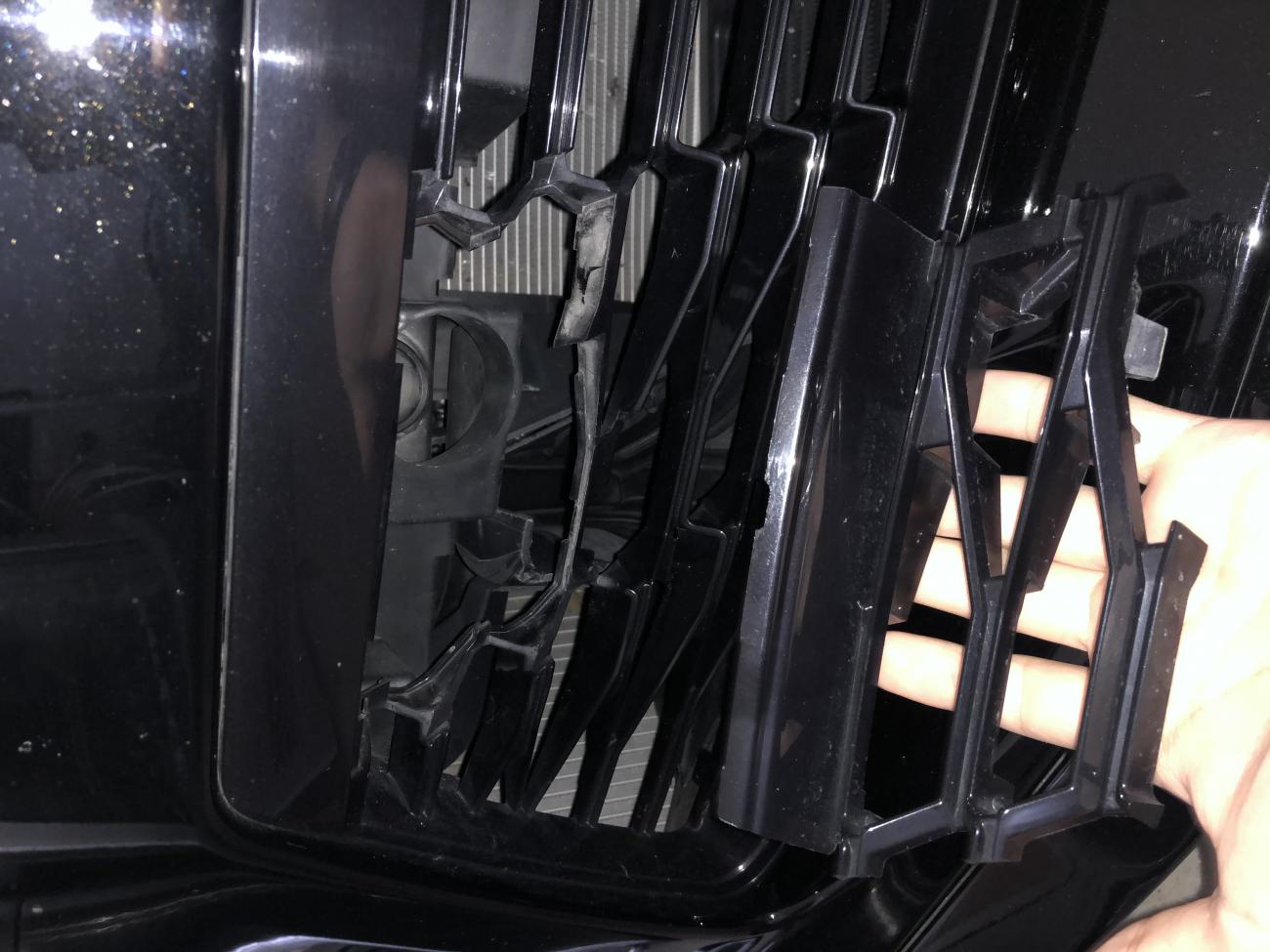

There should be a little tab where you can stick your finger nail in and pop the piece off. Once I get home I’ll get a picture for you on my 2018.

pop it out put the tow hook in easy as pie!

I heard some folks cut out a small area instead, as the pull-out section is too big.

Here the pics for you! I know you have a 19 and mines an 18 but I hope I was some help

Azerlazer26,
How do you make it release, I've tried prying it with plastic tools, screwdriver , I just can make it release.
