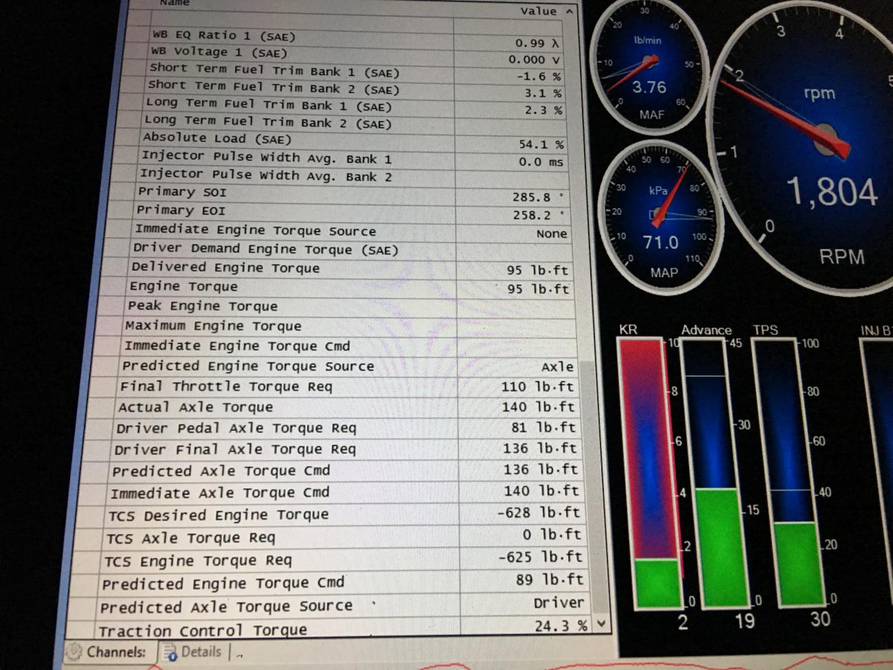

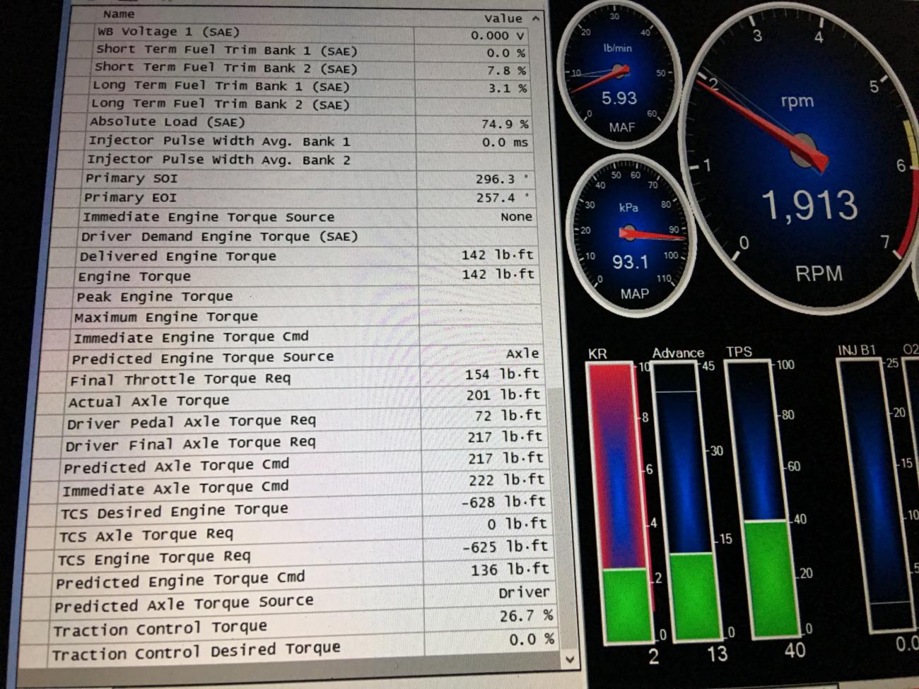

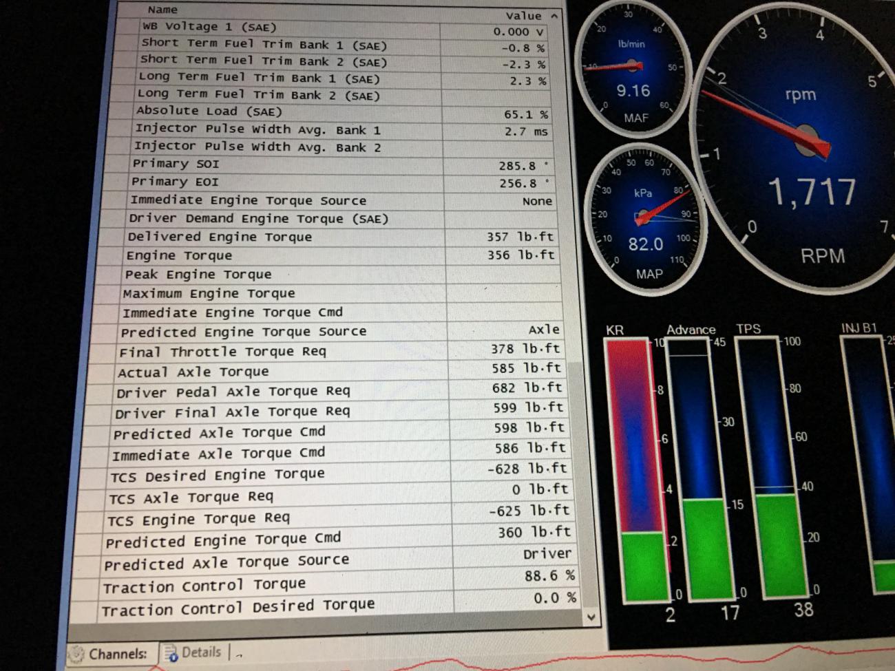

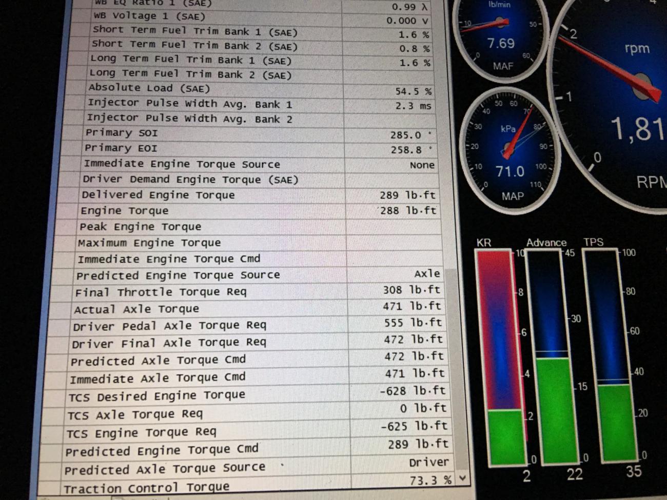

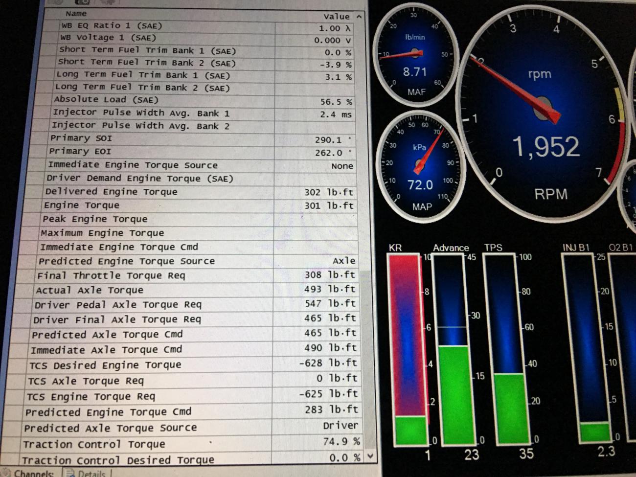

So in the 5 events enclosed, there is one area that has common issues and I don’t have answers. I noticed your LTFT stops logging for some reason in the low altitude log. The high altitude doesn’t miss a beat and LTFT logs are there.
Maybe these screenshots will produce more interest in a solution.
