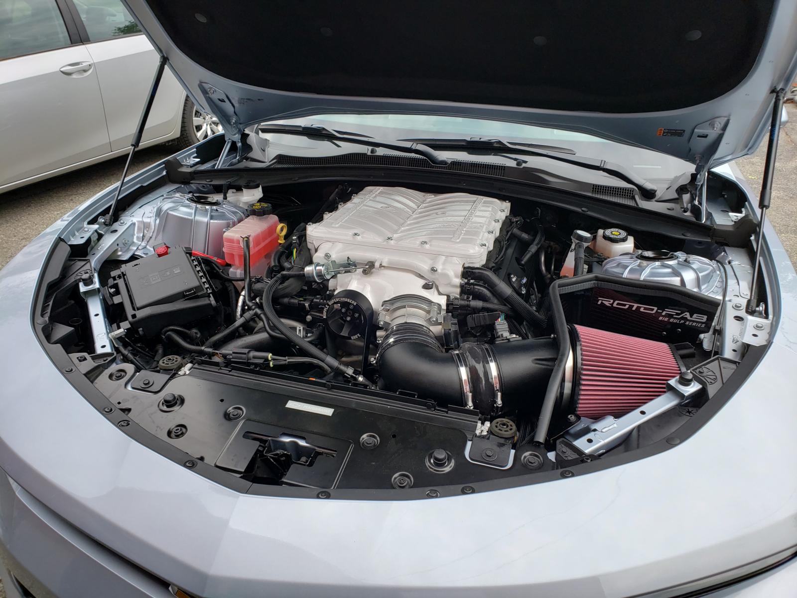

Hey fellas! Well, yet another SS with a PD blower! I went with the Whipple and since my car came with the Ceramic White interior, I decided to go full Miami Vice and have the Whipple ordered with the matching white blower. HUGE thanks to DynoSteve of RDP Store for the great price on my Whipple, NextGen Performance of Spencer, MA for the beautiful installation work. Car drives like stock even with a 5" CAI and bigger TB, absolutely flawless. Couldn't be more happy!
Mod list:
  • Whipple Supercharger with 3.625" pulley (only 7 psi!)
  • DSX Tuning Flex Fuel Kit, running E40
  • LT4 LPFP/HPFP/Injectors
  • Rotofab Big Gulp
  • 95mm TB
  • AWE Touring catback with secondary cat delete
  • Katech 160 TS
  • Stock cam/stock headers/stock cats
Car put down 608 HP and 610 TQ... on a Mustang Dyno! I suspect it would be a bump up if I ran it on a Dynojet. It's screaming for headers and a smaller pulley...! But regardless, totally pumped with how the car runs. Additional thanks to both KingLT1 and SteelHeadRob for their advice along the way.

Congrats on the build looks good. Good numbers on 7psi on a mustang dyno. Enjoy the new power.

Thanks Rob! Appreciate your help and your build journal along the way.

Good numbers! What gear was used for the pull?

King: run was done in 5th gear

how do you like your exhaust set up compared to Stock NPP? been heavily flirting with the idea on moving to what you have (exactly) but when I pulled the fuse for NPP it sounds good now, just on that fence..

I feel like the AWE Touring system is the best sounding exhaust out there, and I've heard a lot of them over the years! Everyone at my dyno day was raving about how it sounded. So I think it's worth the change. But if you live in a small neighborhood or quiet subdivision, you may not want to do it...lol
