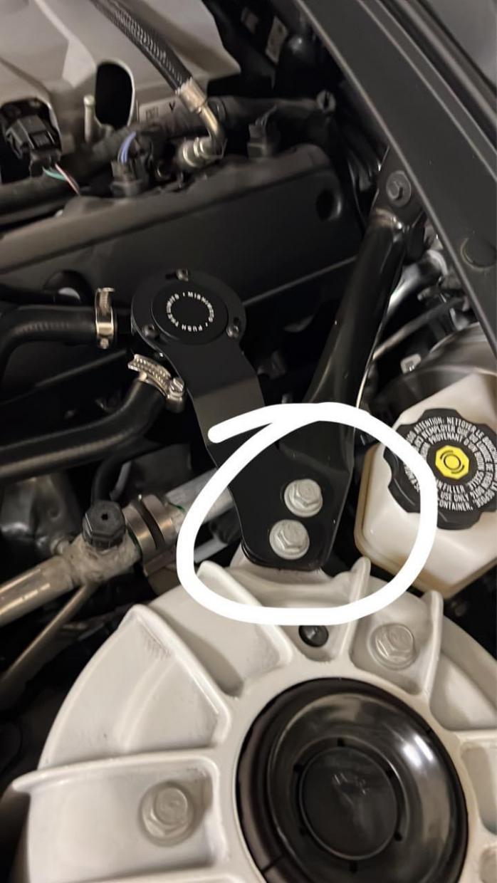

I’m installing a mishimoto catch can on my 21 SS?
I’m wondering what’s the torque on those two bolts?

Okay, okay, Friday tongue-in-cheek time is almost over, here's the actual spec for you (16 lb ft).

The number 2 "10mm " plenum bolt on mine snapped off... whats the part number on it? It cant be 80 ft lbs as mine snapped off.

It says 80 lb/in, not 80 lb/ft

80 inch pounds not foot pounds
6.6 ft lbs if you don’t have torque wrench in inch pounds

well i snapped it off... :'(
im trying to carefully drill it out!
Is there a part number i can ask my chevy dealer tomorrow?

Sorry I don’t have a part number, but it might be easier to remove the brace and then unscrew the broken thread from the other side so you don’t have to do a bunch of drilling
I’m guessing it’s probably a 10 mm bolt which you could get anywhere or take the broken piece to the dealership along with the photo from this thread so they can get an idea where it came from
