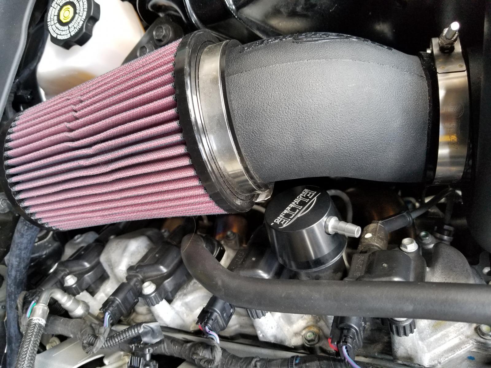

Step 1. Remove the driver's side rail cover (I no longer have valve covers, so that step isn't necessary for me) for ease of access. Loosen the clamp for the filter tube. This will be need to be removed to provide clearance so that you can replace the stock oil cap with the CSS cap. Once the CSS cap is in place, put the filter and tube back and retighten the clamp.

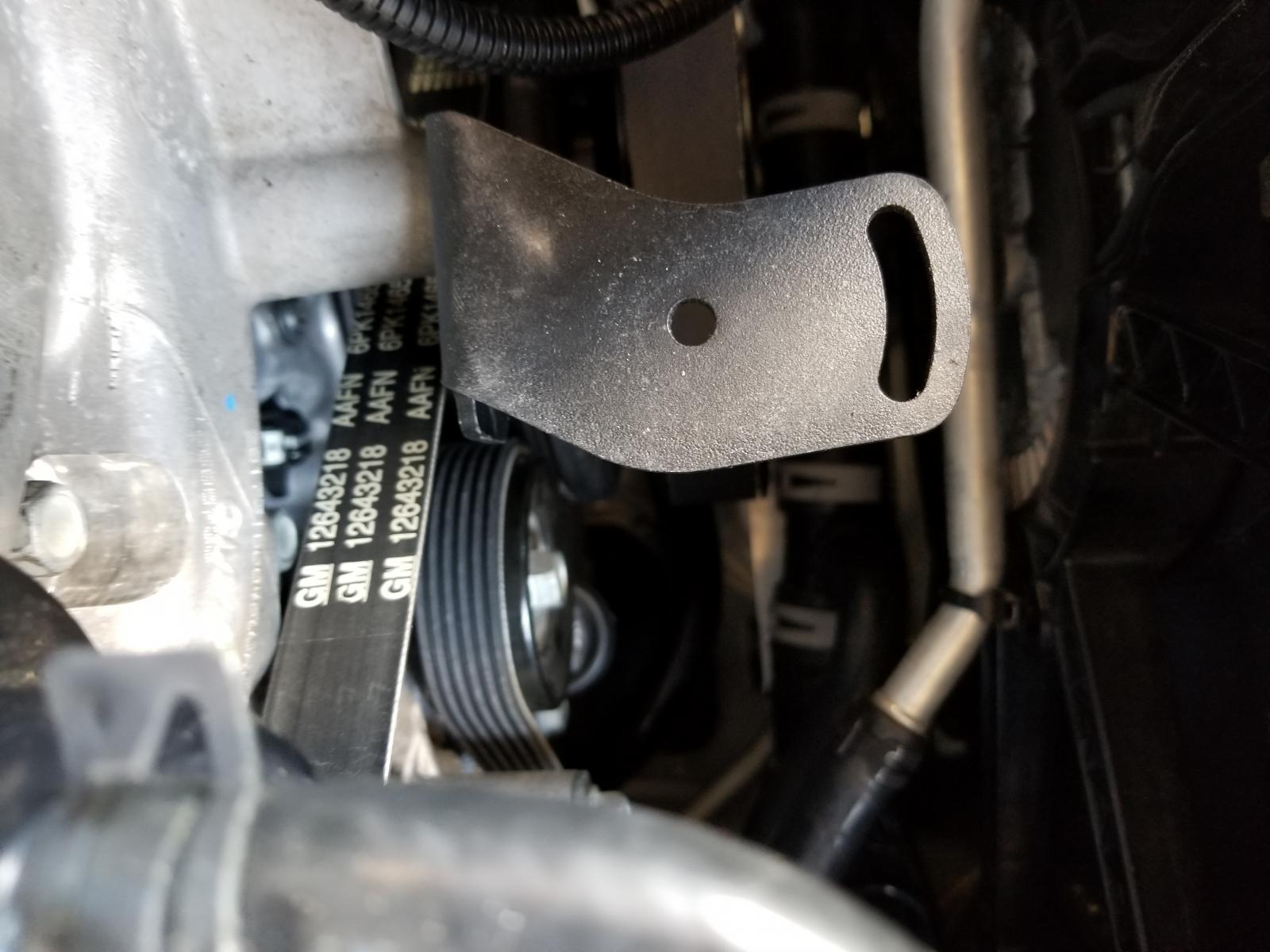

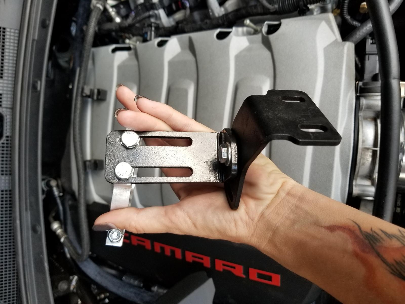

The can will have to be mounted to the front of the block, behind the fan. The provided bracket would not work on it's own, so I found another bracket that we attached to the supplied one and then bolted it into the block.

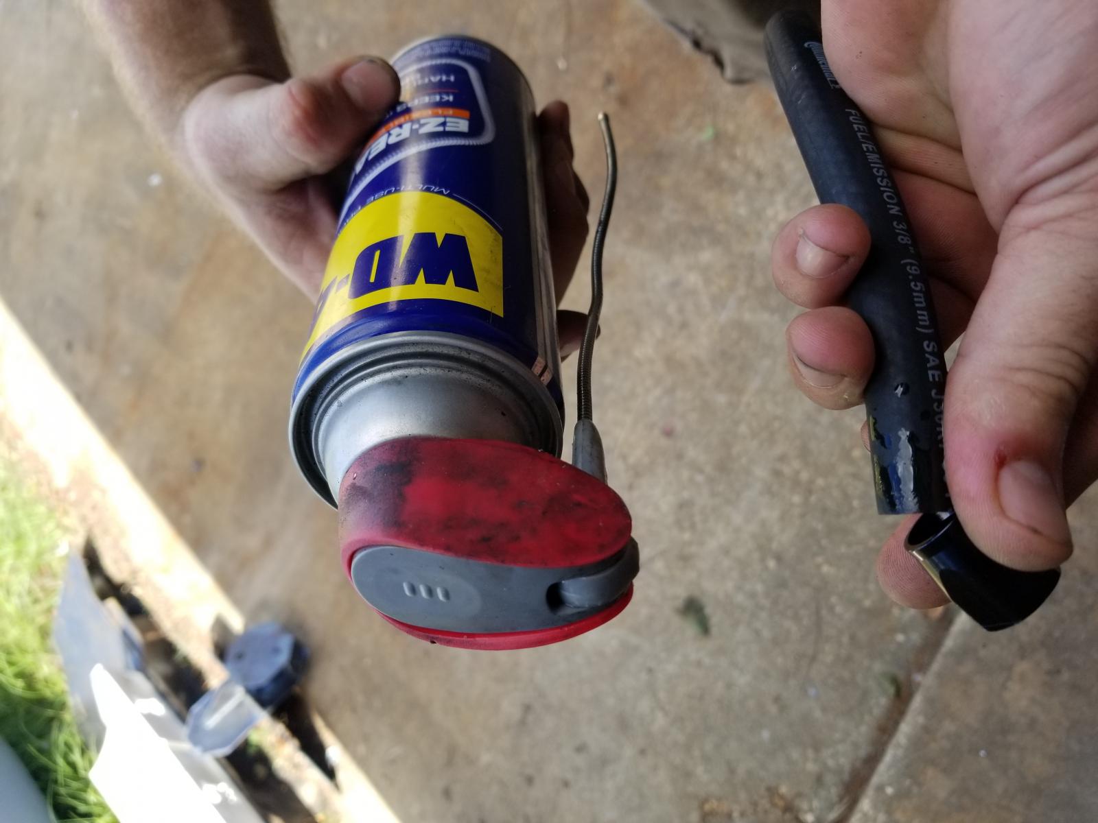

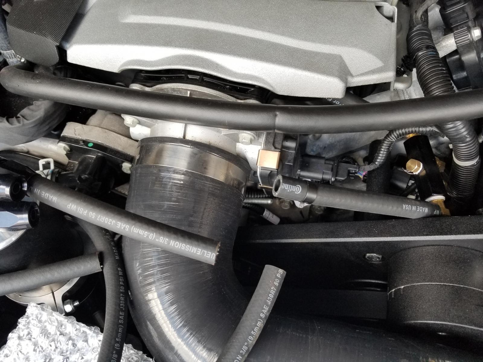

Slide the can in the bracket and tighten. Next, pull the hoses from the input and output nozzles. The input will have a direct hose that goes to the inlet port #1 on the can. Unscrew the black hose adapters, and using a little WD40, screw the raw end of the hose into it amd reattached to the can. For the two outlets, you will need to install the one way splicer (with flow AWAY from can) in the middle of the hose. One will plug back into the output port, the 3rd will plug into the nipple on the CSS cap.

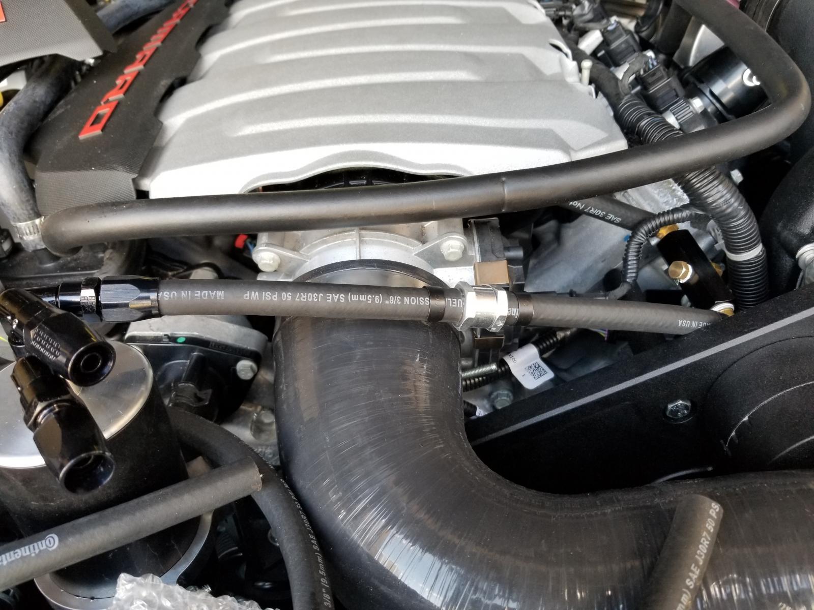

Here is the final result. Total install took about 30 minutes because I had to tweak the secondary bracket to make it fit. Hope this helps others who have a ProCharger and want to install a catch can.
