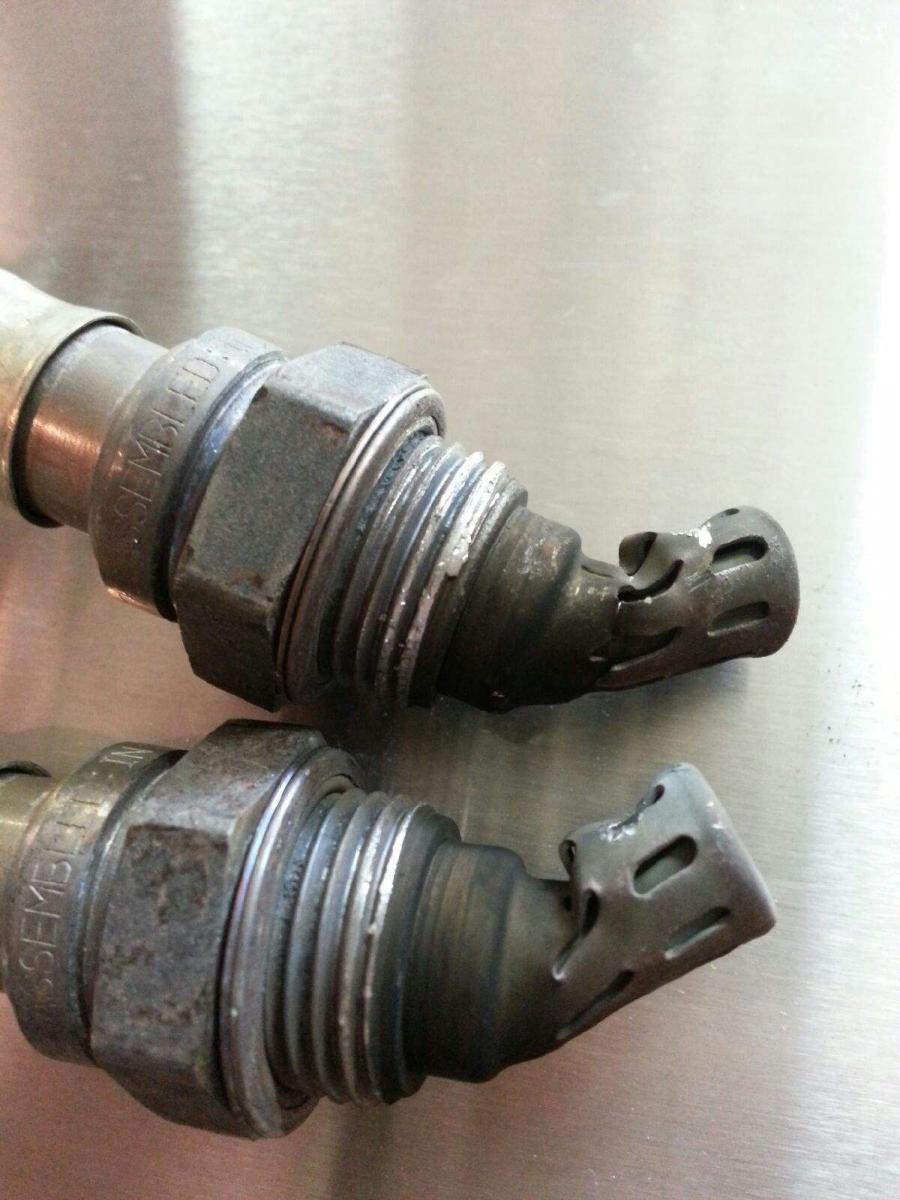

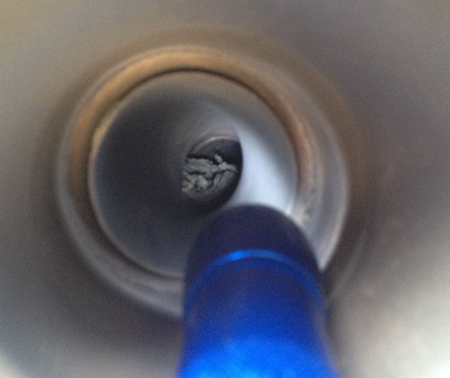

Posts: 38,037
My HF cats didn't last.... and they tend to take out your O2 sensors when they go.
Attachment 978722
Attachment 978723
Attachment 978724
What cats were those?
