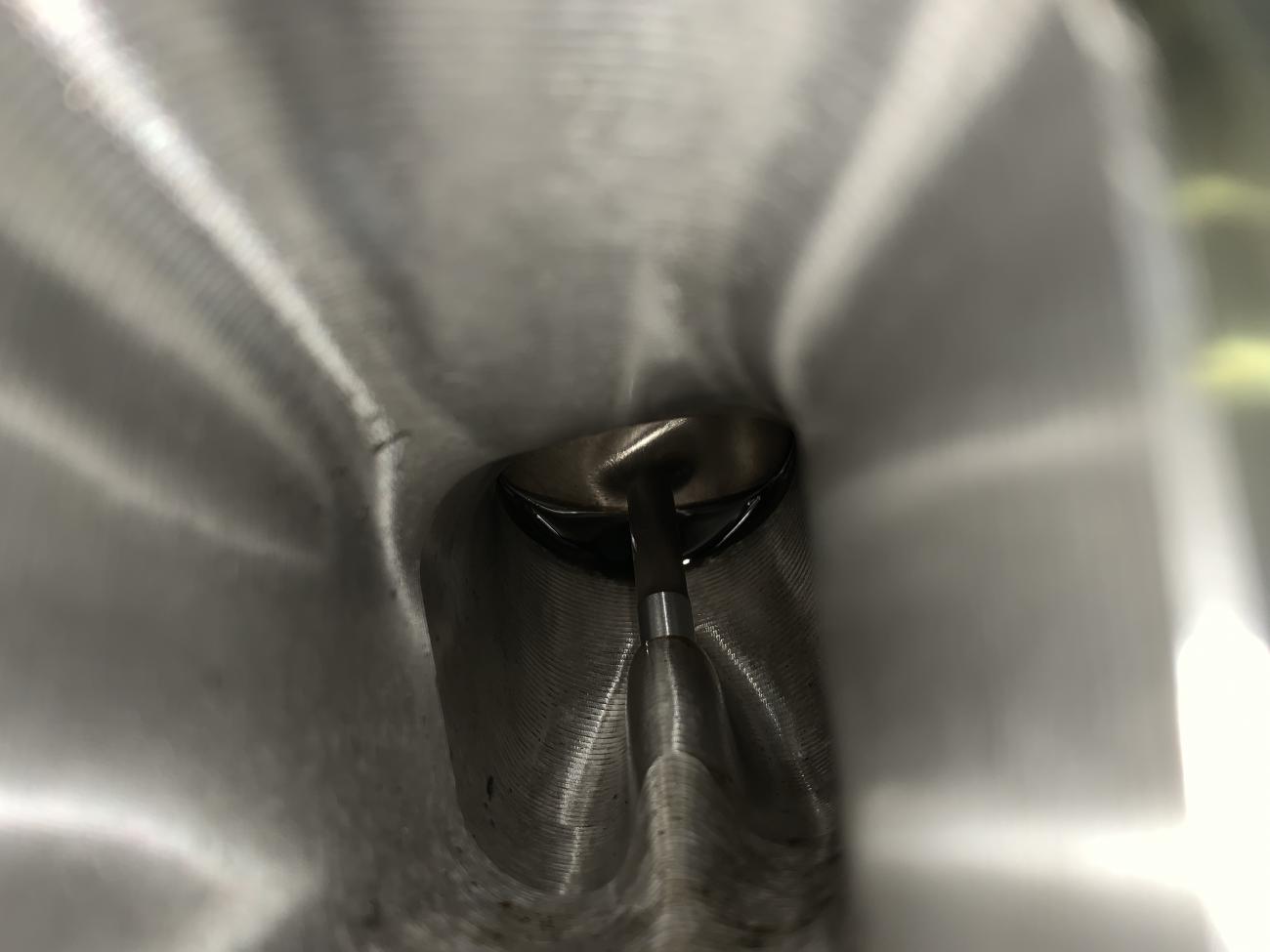

I’m still having oil issues; namely oil sitting on back of intake valves with # 6 being the worst.
I only used one head to fly cut all 8 intake valves and since one head seems to be the problem surely this is the issue?
Anyone seen this happen or maybe have suggestions for a mail to cylinder head shop that could replace the guides.

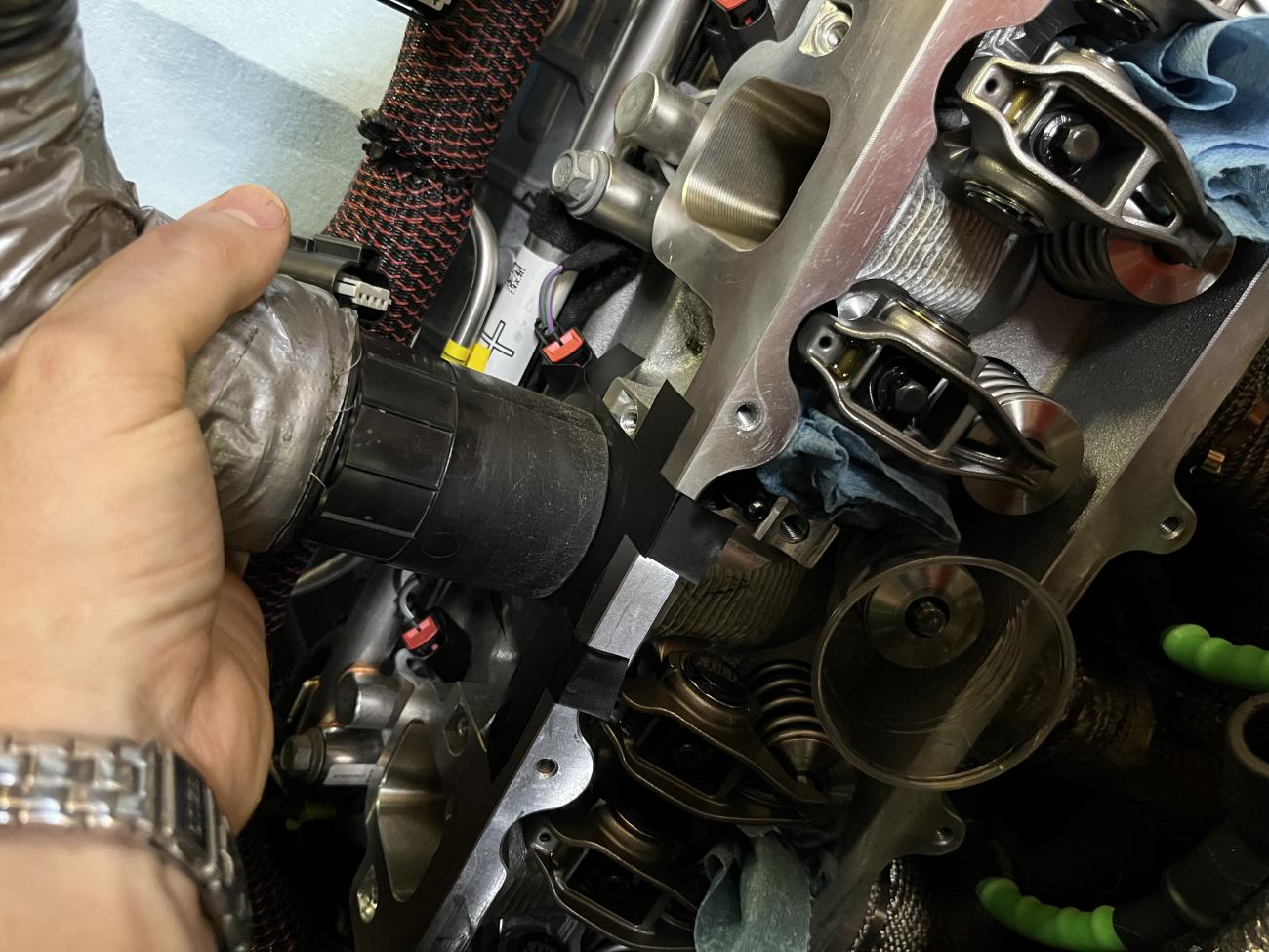

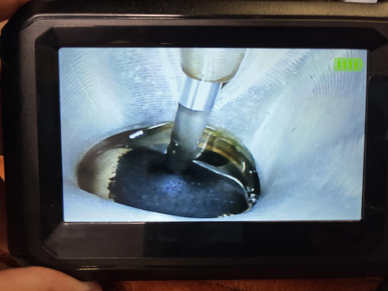

I’m unsure of the validity of this test I created but it makes sense in my mind and points to my guides being out of spec. Laying awake last night I got to thinking about how to simulate oil leaking past the guides and seals with the car mostly put together. Yesterday I blocked the oil return in my heads and tried just pouring some oil over the valve spring assembly but never saw any leakage. Felt that was inconclusive and was thinking about how I’ve read over and over that bad seals and guides will often leak after getting on car semi aggressively and then letting throttle slam shut creating a vacuum that will pull oil through seals. Starting doing research on what vacuum cleaners would pull and learned that the intake manifold vacuum is significantly higher when throttle is shut like at idle. (Average household vacuums are in the 20kpa range my test is with a well used craftsman shop vac but would still be significantly below vacuum in manifold.)
Test procedure:
Cut a hole in a small plastic cup to place over spring to simulate oil in head.
Vacuum hose was just slightly too small to seal around intake port so I used electrical tape to seal a little better.
Turned vacuum on and began suction
Poured oil in cup till it was at the top.
I forgot to start timer but wife said vacuum was running about 3 minutes before oil ran out of cup. (It was not a perfect seal at bottom)
See pics.

Are you certain the intake rocker arm bolts aren't coming through the port? I have seen core shift on heads that allow the intake rocker bolt to poke through only certain runners and not others.
Also check the roof of ports for hairline cranks from spring pocket machining.
