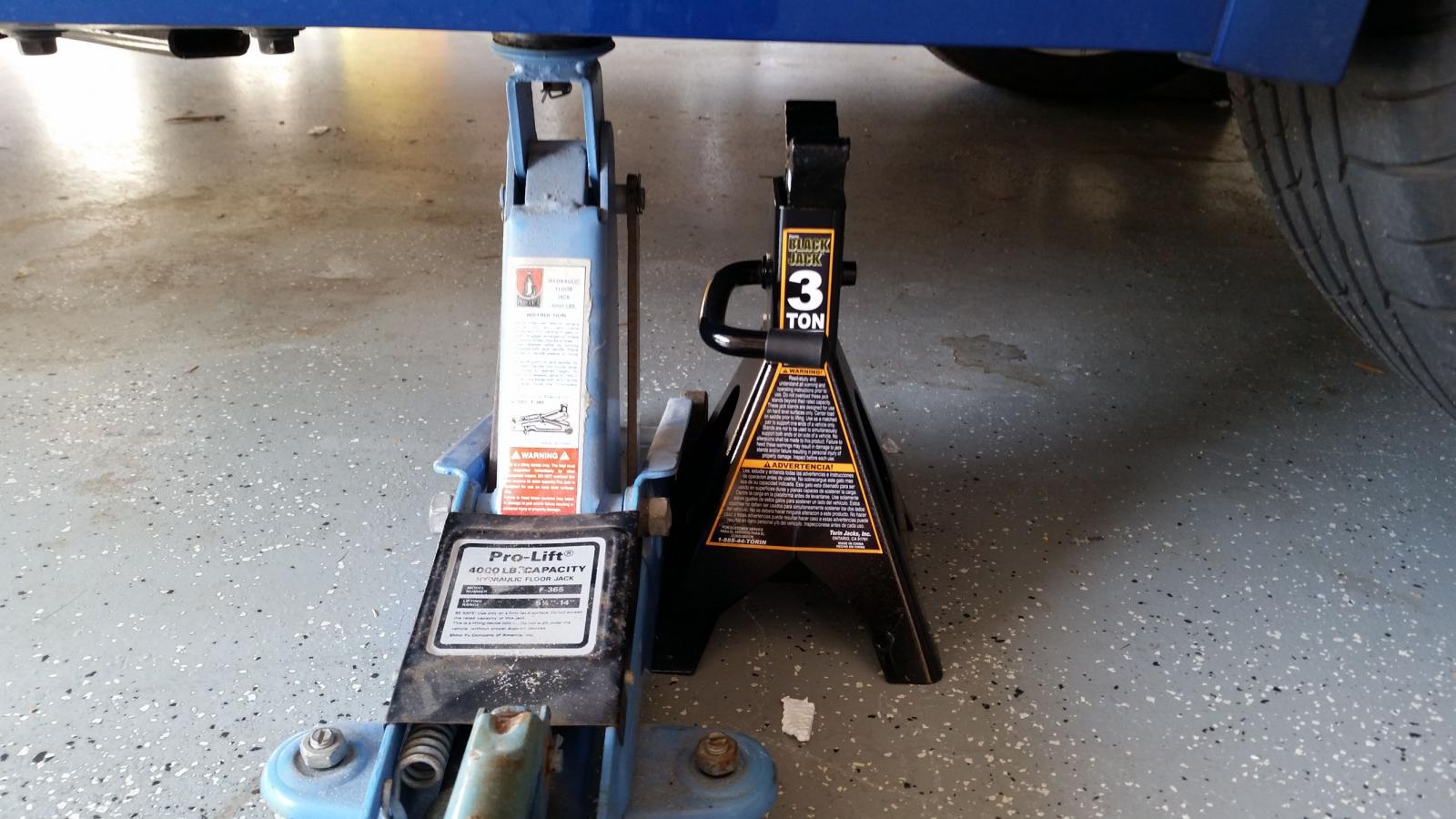

OK, still looking for help here. I bought jackstands, and tried to use the same exposed pinchweld for the stand and the jack, but there's not enough room for the bases (jackstand base is too wide, even with my narrow-ish jack).
The 'vert has the cross-beam reinforcements on the front, I could probably fit my jackstand on this beam, but its hollow tubular steel, is this a bad idea?
Thanks for any guidance/advice,
Joel

OK, to answer my own question, and hopefully help someone else, you CAN use the second pinchweld for jackstand support. I wasn't sure the cross-struts would hold the weight of the car, but no problema (and no damage). Just make sure you seat the jackstand under the bolts connecting the cross member to the pinchweld. . .

I'm having trouble telling from that picture exactly where you put the jackstand. Which point exactly is that (i.e. front passenger side)? Your previous picture shows the tubular brace about to sit down into the jack but I'm guessing you didn't do that and instead positioned one of the bolts to sit down in the jack. Any better pics or can you clarify?
I'm assuming you do the same in the rear as well?
