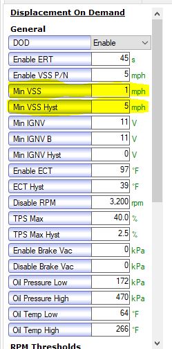

has anyone played around with the settings? Im wanting to raise the speed at which the vehicle needs to be going before it kicks in. Thinking about setting it up so it wont enable below 45 mph. Just wanted to see if anyone else has done anything other then just turn it off.

as others have said its with using hptuners and its under fuel, lean/fuel savings tab
The reason I wanna change it is around town its kinda annoying since we have a lot of very steep grades and it will constantly kick in and out. With the drop in mpg after turning it completely off, I figured this would be the best of both worlds.

Just wanted to update this and say it was a success....kinda. It stayed off like I want it to and started @ 50mph. I had the settings set at 45 for the min vss,and 5 for the min vss hyst. The only reason I said kinda is after it turned on, I assumed due to the settings it would switch back to v8 mode if it went below 45 mph. It stayed on until I pushed the throttle (like normal) or came almost to a stop.
If anyone has any ideas about that please let me know. Im really happy with the results as it is.
squish72 is offline   Reply With Quote

Can you elaborate more? Just to kick on or to shut off? Mine works great and will not kick on 50+ like I want but I wont dissable on it's own at 45
