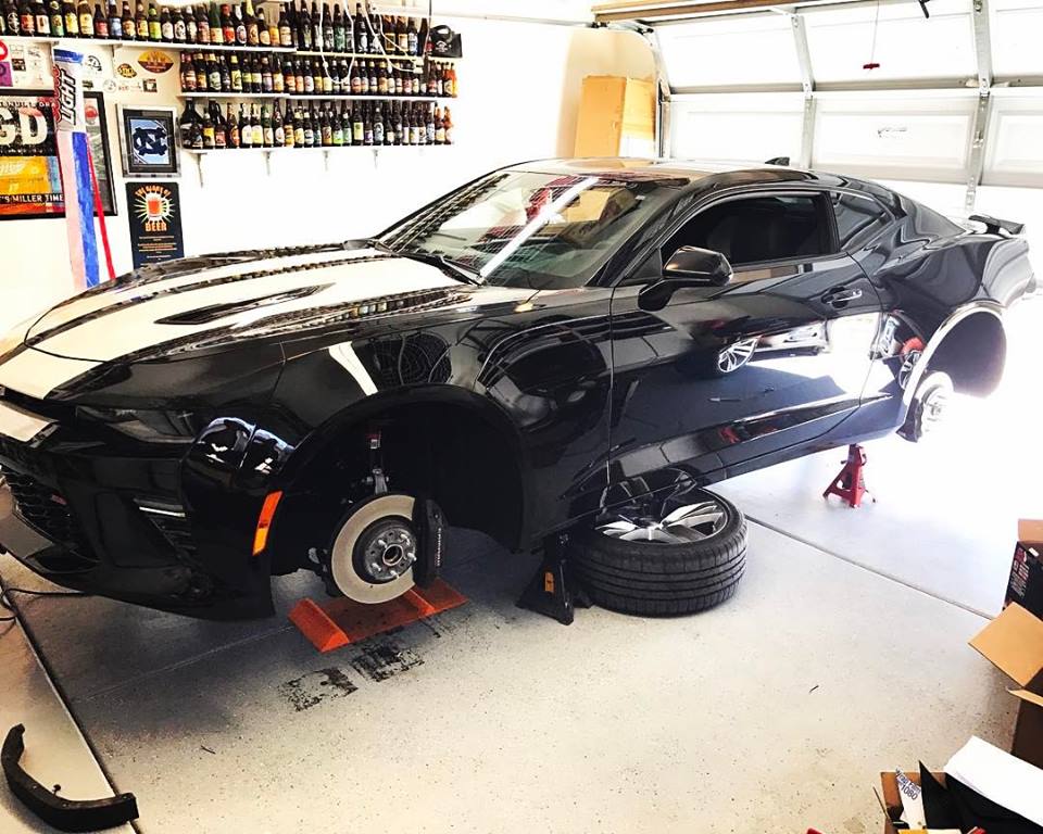

I've been using just the pinch welds for my jack stands and so far so good but I do want to get something a bit sturdier so I don't fold one over. Has anyone used the ZL1 Addon bolt on lift points with Jack stands? I'm a little worried that they aren't wide enough front to back to be stable and too wide side to side to fit in the jack stand notch. I'm talking about these lift points:
https://zl1addons.com/collections/ja...nt=32532898497
With this style of jack stand:

Super stable. The lift points fit inside the curved part of my jackstands. Rock solid.

There was a warning, on the web site, about NOT using the mag pad or mag puck with Jack stands. I am not sure about the bolt on style. I would contact ZL1addons and ask them.

The add on pads that bolt onto the car are fine. They attach to the pinch weld but the solid part goes all the way up to the flat part of the sheet metal. This is what keep them from folding over, they physically cant due to how they are designed and sit.

I'm not worried about the actual part being able to handle the weight or not, I'm worried if they are so small and smooth that the jack stands have the potential to shift when lifting the car and have the jack stands slide off of them sideways (the lift points are angled).

I posted a picture in this thread how these sit on the jack stands
http://www.camaro6.com/forums/showpo...6&postcount=21
I would have liked it if jack stand could fit under these in a T manner but they were pinching against the rocker panel.
I don't trust the setup if I need to work underneath the car so built a pair of wooden ramps.

I gotta be honest, those pics give me anxiety. I was worried about putting the jack stands the other way. The way you did it looks like a death trap.
Either way, thanks for linking so that I can get an idea of the size.

I have my jack stand 90 degrees rotated from the above thread's pictures. They're super solid.

I have Torin's 3 ton model with the locking pins and they won't fit like you have mentioned...just not enough clearance from rocker panel.
