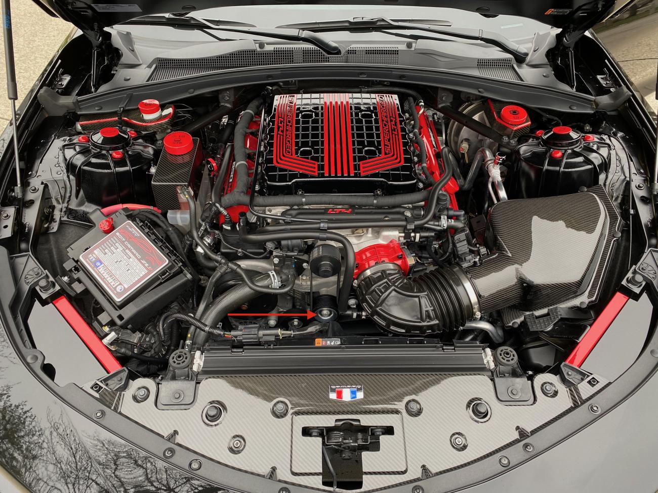

That's the exact same sound my engine made when it had a bad idler pulley. The sound would vary with RPMs.
I've included a photo with an arrow pointing to the pulley that was replaced.
I diagnosed the bad pulley with a 3 ft wooden dowel. Put it right up against the front of the pulley with the engine running and you could hear it buzz when you put your ear up against the dowel. It also vibrated like crazy in your hand. An automotive stethoscope or long screwdriver can also be used to check if the pulley is bad.
I had the pulley replaced under warranty in 2018 and no problems since.
Old 05-07-2021, 02:07 PM   #12
Tyrolblue67
Drives: 2019 ZL1 Camaro
Location: Motor City
Posts: 224
I would take a look at the idler pulley as well.
Could be a bad bearing or assembled backwards at the plant causing too much tension when the bolt was torqued down.
Is the silver dust plate just below the bolt on the idler pulley discolored?
Heat from friction could cause the dust plate to turn yellow, blue, green and orange like a rainbow.
