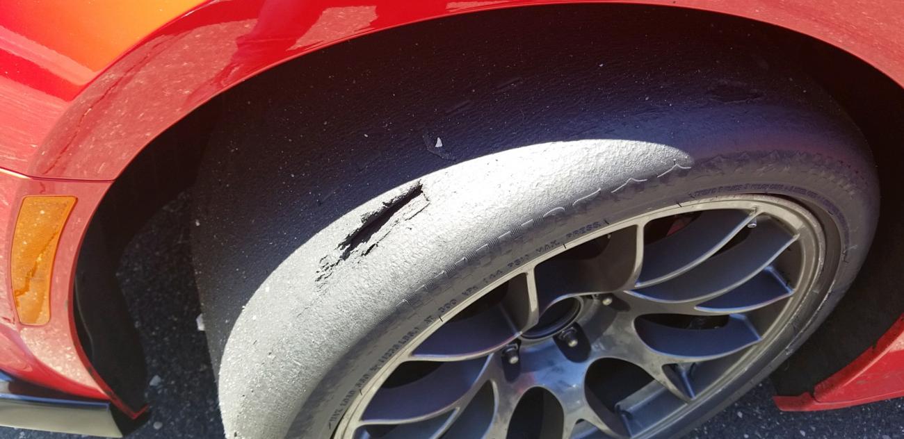

Yeah running 1le alignment specs did not fair well. Driver front tire rolling over real hard.
Car is at shop now getting 3.5 in front and 2.0 in the rear.
Suspension is all stock Maggie Ride with camber plates.

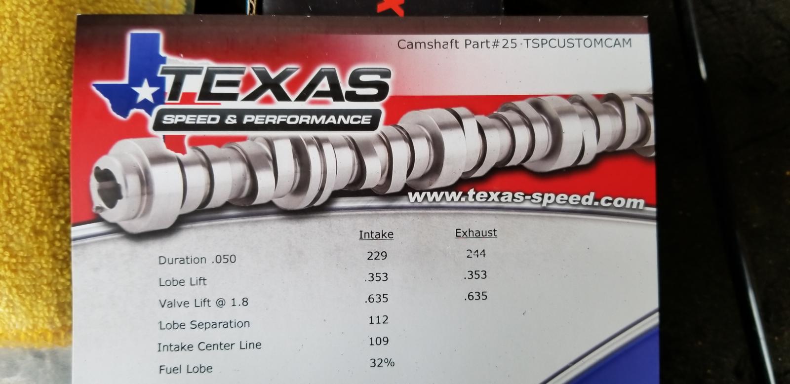

Thanks for posting the video. I love the lope! I have a well warmed over LS2 GTO (LPE GT1-1 cam) and just sold my dry sump LS7 Firebird (big LPE GT21 cam) [Red like yours]. Makes me want to do heads / cam with my 1LE and put the ZL1 1LE aero on. That would be awesome.
What are the cam specs or link to a cam card on it?

one more as per request.
should be interesting to see what the thoughts are with the gurus here.
Not a cam that is for a novice tuner for sure. 112 LSA
