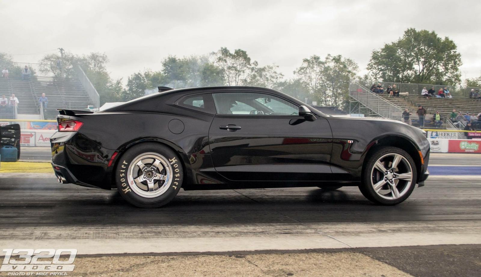

I just ordered a set of the RTS S71's in 17x10. Gonna slap a set of 26x12.50 radials on them and see what it does. Should have numbers on Sunday.

Picked them up today. 28x10-17 Hoosier D06 on RTS S71

These Weld's fit perfectly without rubbing on a darn thing. I forgot about this thread once I started getting to run hard and realizing I had a bunch of tuning work to do to get full advantage of the tires.
No rubbing, no grinding anything. You can even use the stock lug nuts if you use a thin wall socket.
Next purchase will be matching fronts and skinnies.

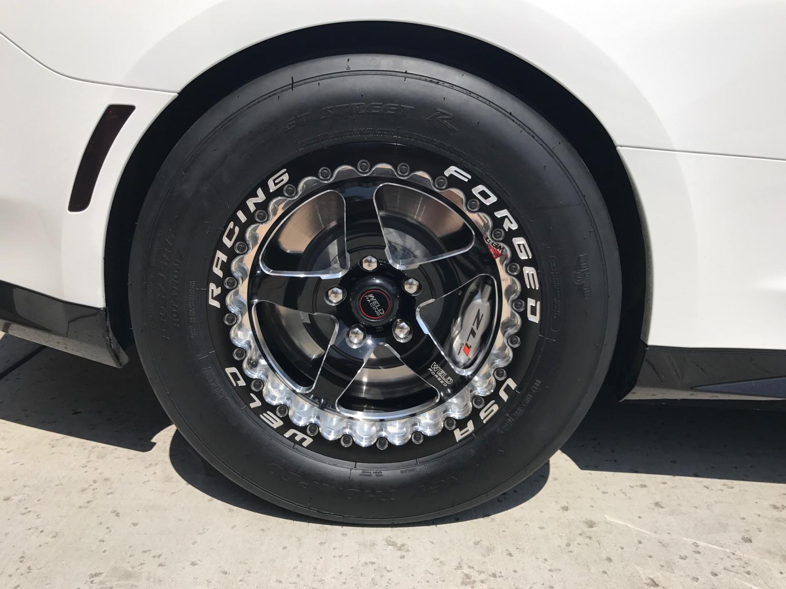

I have 17" Welds and they fit tight but perfect no cutting no grinding.
