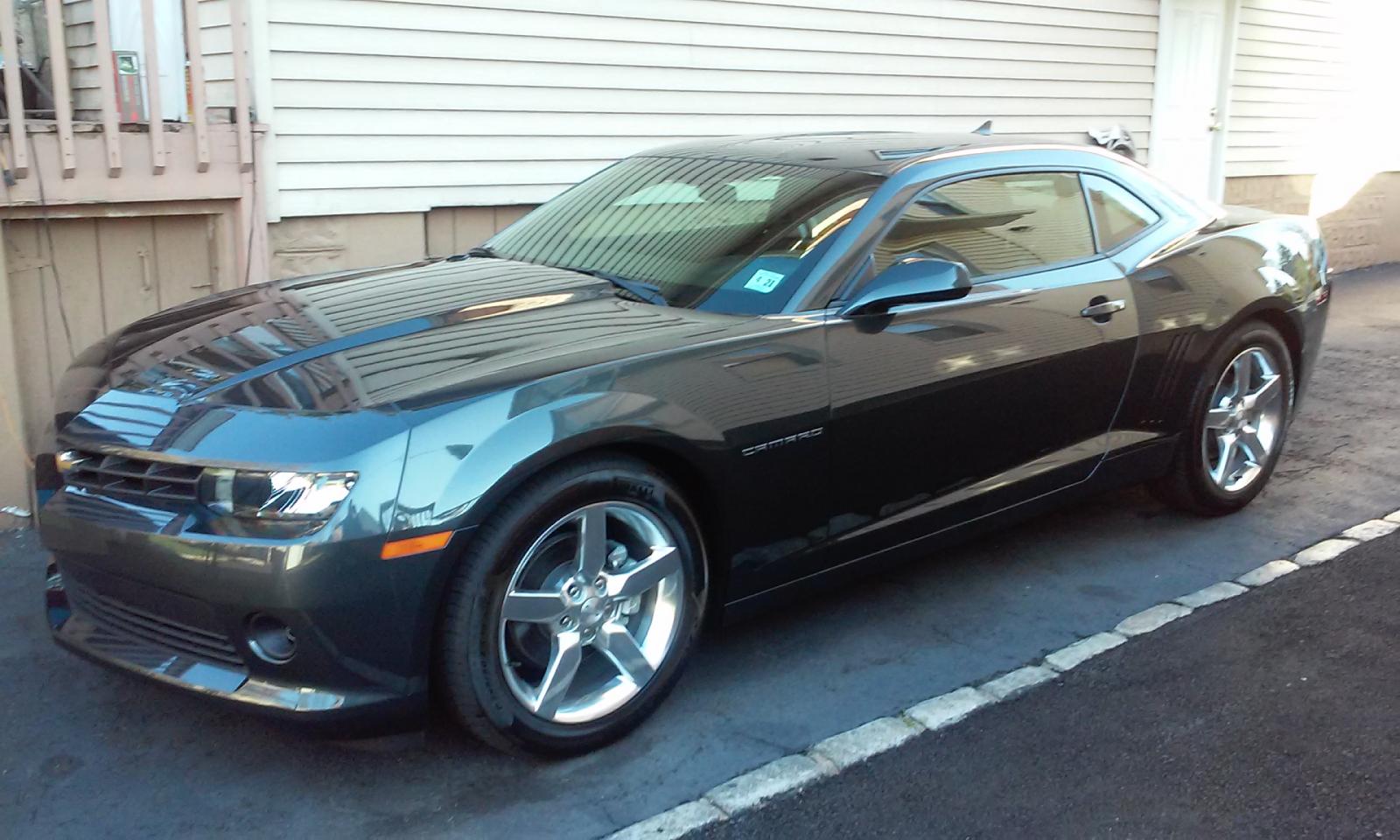

Hey guys thanks for all the great reply's I made a mistake stating my stock /factory tire size, it is 245/50/18 not (55), so with the change to
245/55/19 I'm seeing in the post above it will be off a couple mph's,
faster or slower?
Also the reason I'm going to 19" is I can get perfect stock factory rims from a 2015 for a trade deal(from the person that bought my 2015) I like those style polished rims.
Here is a pic of the rims;
Attachment 926691
click the link in my post above it tells you everything you need to know including speedo error.
