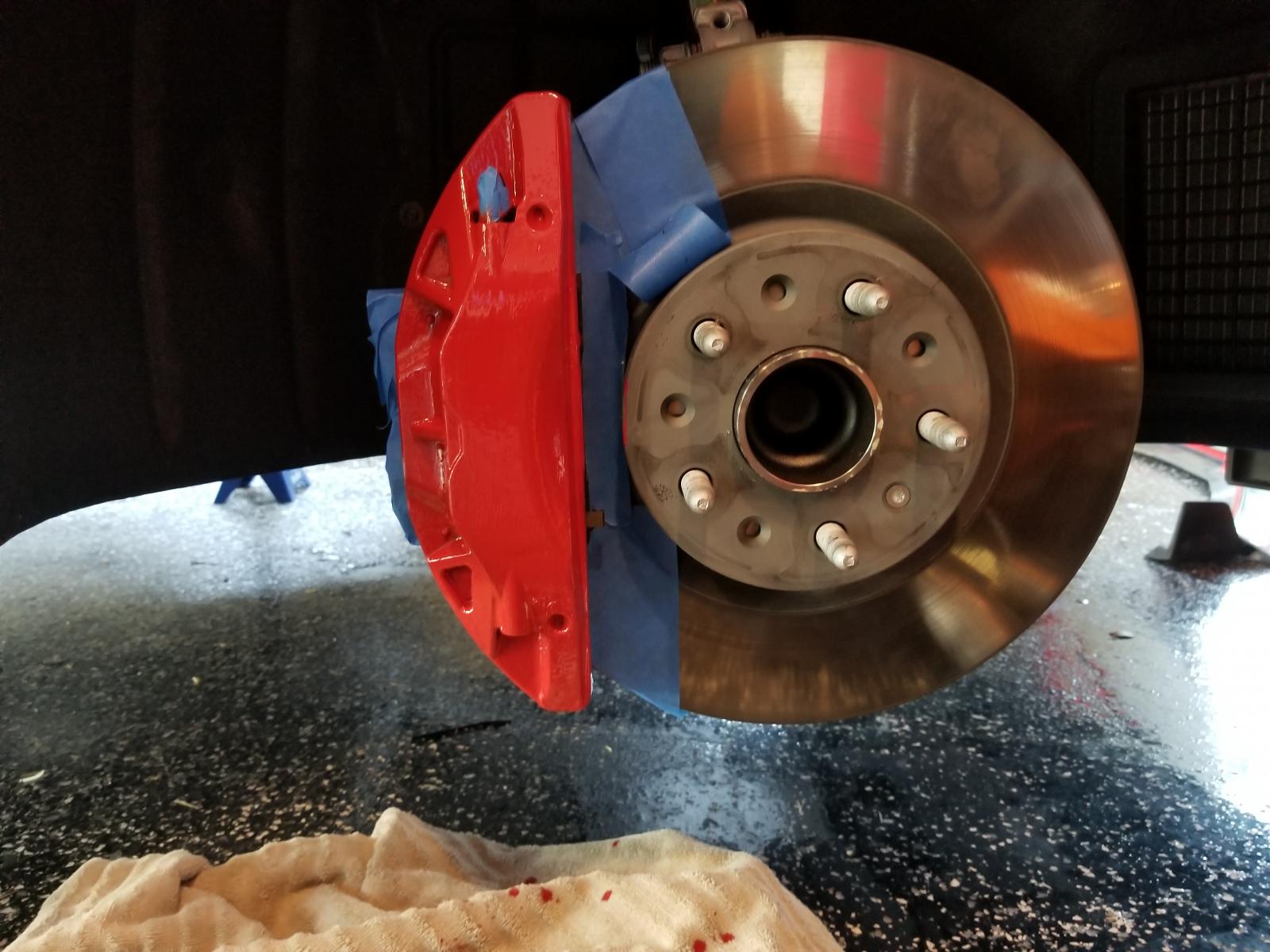

VHT or nothing...I'm biased.
http://www.camaro6.com/forums/showpo...7&postcount=11

Nice! Is baking necessary or optional?
srcstc is offline   Reply With Quote
Instructions say recommended.
It also says that the regular braking temperatures would bake the paint as you drove around...but I didn't want to chance any debris or dust contaminating the paint job, and since the calipers were already off the car, I opted just to bake them. 1hr @ 200 deg.
