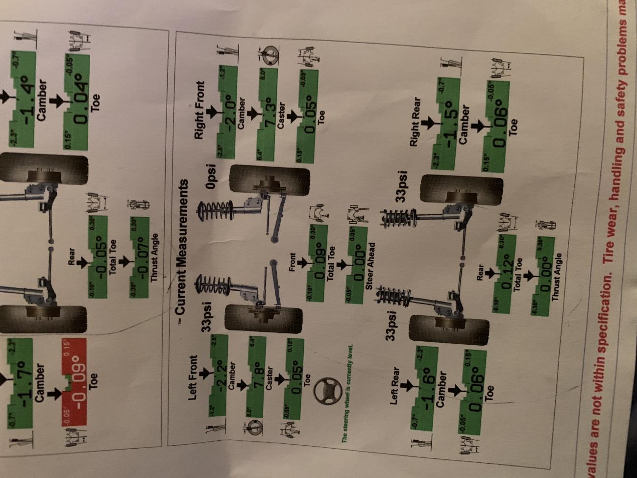

Had the 1le track alignment done today. Out of the shop the car felt great. I brought the car home, washed it, had dinner and took it out for a quick drive. The steering wheel is now slightly off to the left while driving straight and the car wanders all over the road during hard acceleration. Any chance the car could have came out of spec?

Here is the alignment sheet

It's very possible they forgot to torque something. Another member found his front strut loose after the dealership aligned it.
I'd call them in the morning and tell them exactly what you said in the first post.

Stopped in after work today and they made right by everything. Happy to say that the car feels better then ever
