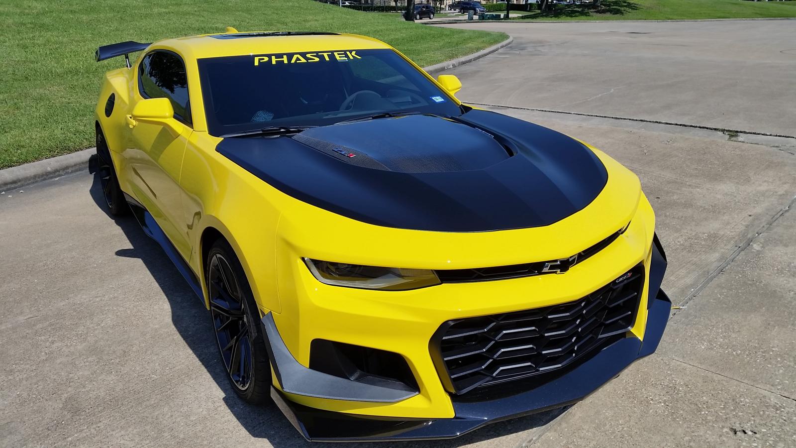

Well mean while I got this to add to the yellow collection. I would say the wife's car is faster on the hwy but not off the line or a slower roll.

Nice Ride!

Thanks.. I love her eforce car but this zl1 feels totally different. .

Wow!!! Very nice Jack!
