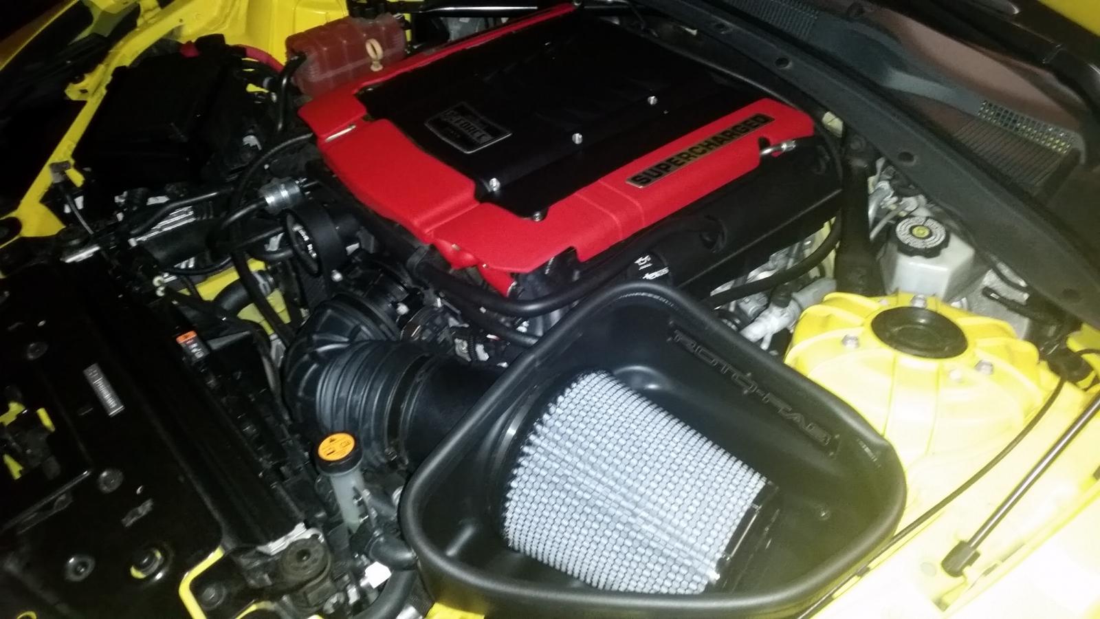

Edelbrock eforce owners Rotofab results to come..

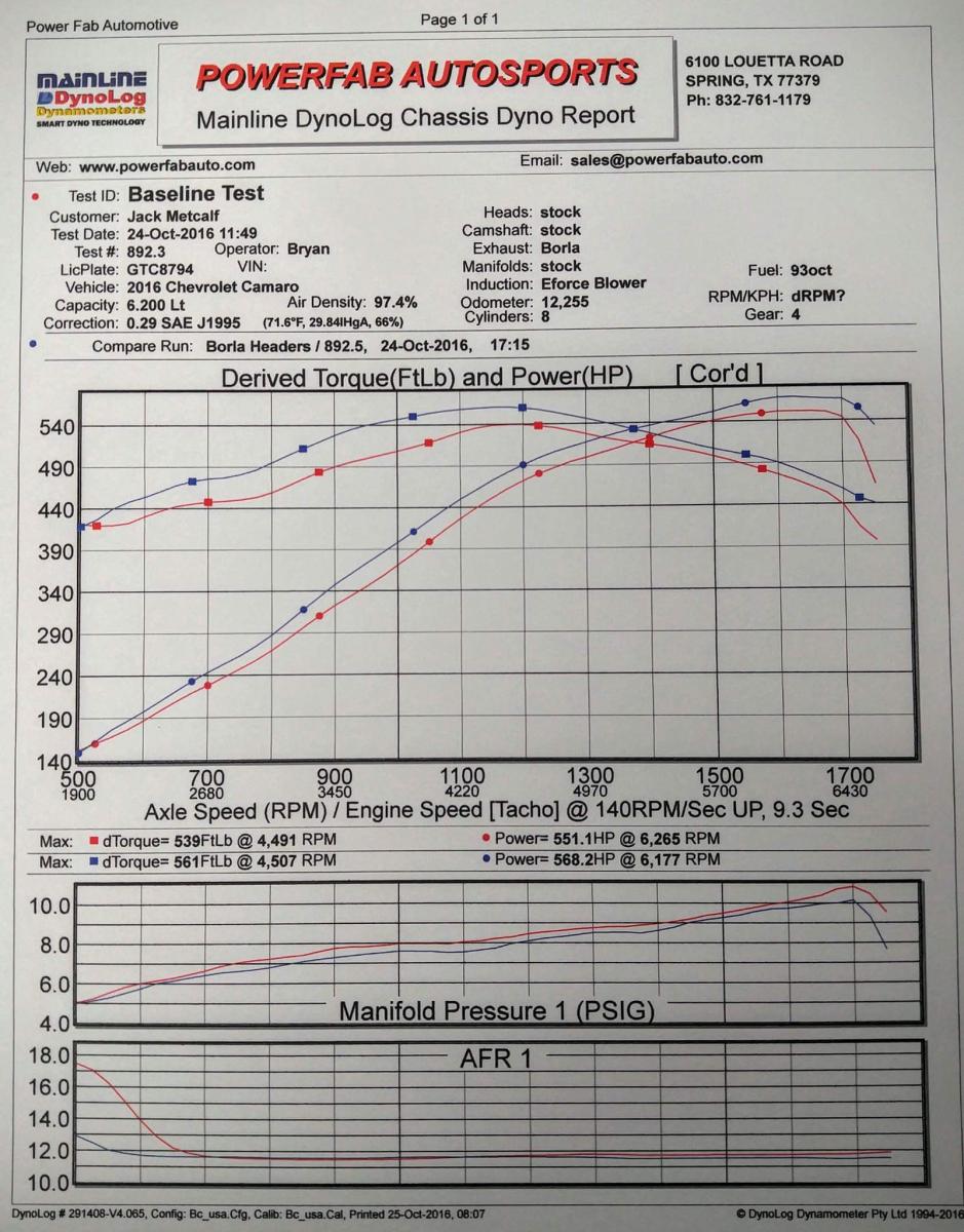

Here is the rotofab install video from phastek performance to show the quality and the fitment of the kit. The performance gains video will be next week. The base line dyno with no mods were 417 rwhp and 413 lbs of torque. The eforce and factory airbox are on the attached sheet then the eforce with Borla headers. The rotofab intake with Borla headers will be next to to see the power gains of the cold air intake. All the test are performed at the same speed shop and the same main line dyno. I was told they read very similar to mustang dynos.

Nice, so the gains shown here are for the headers only? Is this a complete exhaust system or just headers?

The Atak was the first mod and was on the car at the stock baseline. This was the Borla R & D car, we bought the car and not 5 days later they came and picked it up had it for about 6 weeks and designed all the exhaust systems and started on the header's design and finished up the headers with maroless's car.. they had his car for a bit to hinse his nick name lol. Then about 4 months later we drove from Houston to Tampa averaged about 26.4 miles with the cruise set at 75mph on the way there so that an Eforce supercharger could be instaled by the television show All Girls Garage it appeared on velocity channel on October 1st. We drove the car back and averaged 24.7 mph at the same speed. As it turned out the headers R & D finished about the same we were done filming we got home and they were waiting at the door. They set in the living room for a whole week to where finally we couldn't stand it and had to install them. The rotofab was put on yesterday and this is where the car is at as far as mods go.

Thanks for throwing these dyno runs up Jack. It's interesting to note that your baseline run is almost spot on with mine.
I also think this is the first direct comparison of a PD, E-Force anyway, delta power between stock headers and LT headers.

Thanks ed.. driving home from phastek last night I swear it felt a little more stronger..

Can't wait to see the results! Looks great Jack.

So with a stock car aside from eforce you put down 550 plus hp?

551 stock airbox no headers using the CAN tune provided by Edelbrock loaded w the sct tuner.
