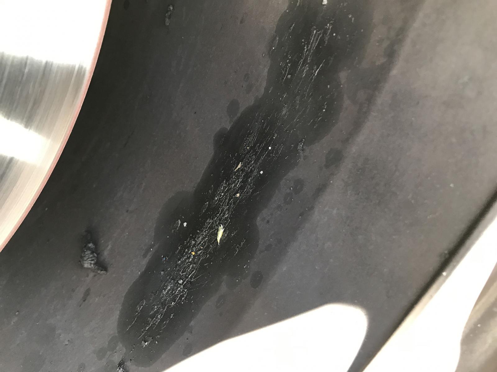

I did have a concern with the front outer brake caliper bleed nozzles seeping. Even after they were tightened up and cleaned up, they wept again. Anyone else observed this? I think I had seen this issue with the C7 on the Corvette forums, but not sure what the fix was. Also, the brake pads had tons of greasy goop that melted and splashed all over the inner side of the wheel barrels. I worried it would get onto the pads and rotors but after 3 sessions it stopped melting. Pics are attached for reference.

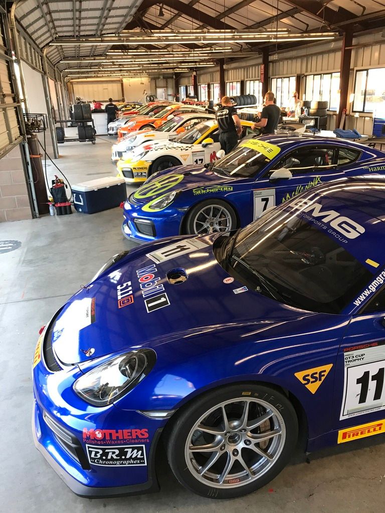

Nice driving, dude! I was there a few weekends ago working for GMG on a few of their Cayman GT4 clubsports that are running in the GT3 Cup Trophy series. Awesome track, but DAMN was it hot, and I live in Phoenix

congrats on the car and your first event. Small weeping on the brake fluid is normal. It happens to me too on the first session after I bleed the brakes before an event.
You may use some water and towel to clean it. Make sure you don't over tighten the bleeder screws but they're also tight enough.
If you have an air compressor, my friend mentioned that he uses to get rid of the small amount of fluid in the screws after tighten them

Nice, my favorite track for sure! My calipers weep as well, it must be 'normal'. It can be an intimating track to really push yourself, so don't harp on times too much. I posted a video in the track section if you want something to compare to. Hope to see you out there sometime!

Regarding the brake bleeders, you're not alone. The more time elapses, it seems the 6-piston calipers are prone to leaking. Mine were weeping and it took 4 heat cycles to snug them up enough to have them finally stop. Jaymsu also recently put the 6-piston kit on his SS and he had to quit his last track day early because his calipers wouldn't stop leaking all over his wheels, where his stock 4-pistons were fine. We're both veteran track guys with a lot of experience under our belt; the bleeders are at fault here.

Hmm. I wonder if it is a safety problem or just a potential cosmetics issue with brake fluid eating away at the caliper paint and the wheel finish? I'll keep a very close eye on it this weekend, I'm headed to Auto Club Speedway for my first time at that track. Worried about braking into Turn 1 after the oval section!
