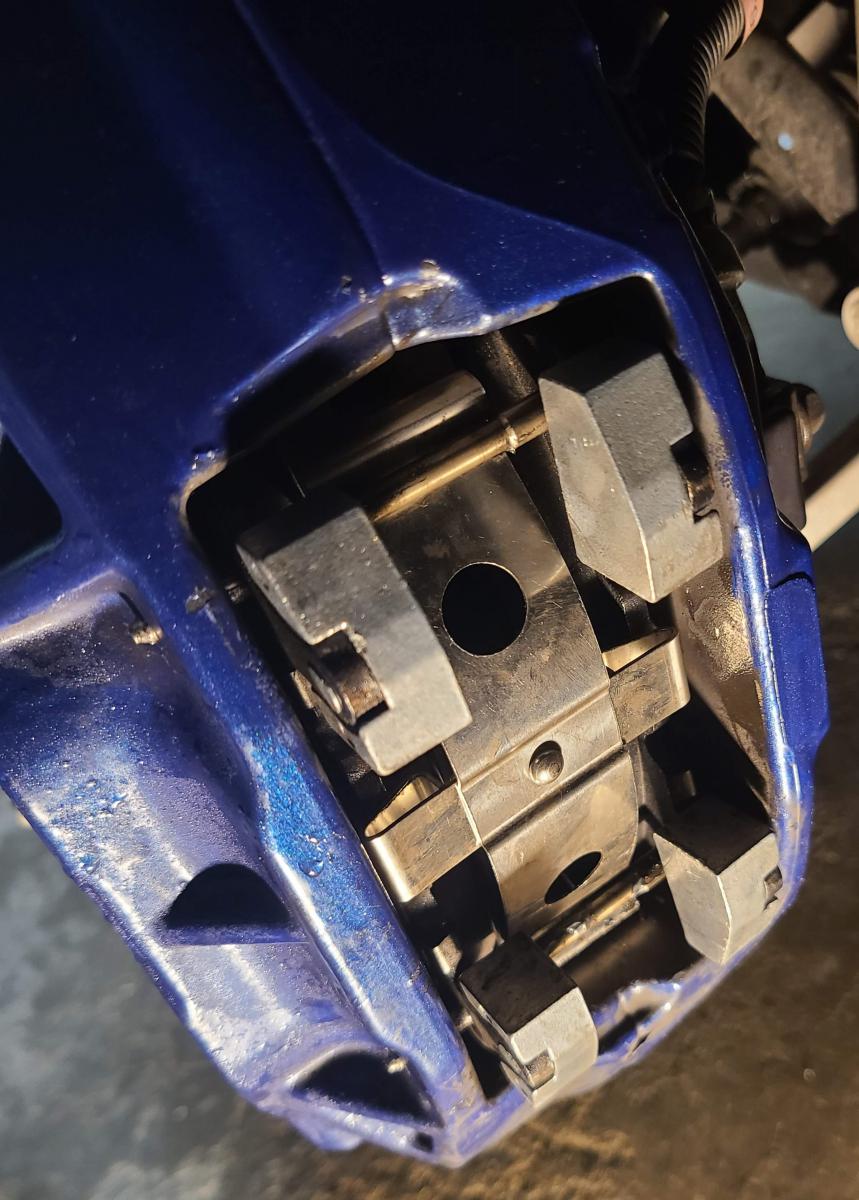

Would it have anything to do with the metal "clip" that goes over the pads? The clip that Powerstop sent doesn't even resemble the clip that was originally on the pads, and it bows out quite a bit. I can get a pic shortly during lunch break. I kept the original clips & pads since there's still about half of the life left on the pads (in case I need pads in a pinch).

Here are the pics of the clips sticking out.

I bled/replaced the brake fluid today. I had also messaged Power Stop. They said I had installed the brake springs backwards, so I also turned them around. Now the brakes are better than they were before. Very pleased with how it turned out. This is how they're supposed to look, along with a pic of the bleeding process.
Those springs are installed backwards, you need to turn them around...
EDIT: Just saw you found that out from PowerStop...
