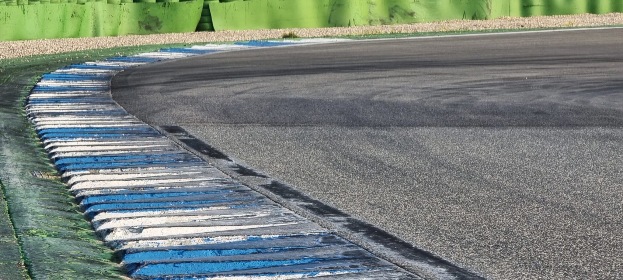

I have about 32 track days on mine (5th year now), with 19K total miles (including off-track) and mine look fine. I wonder if it has anything to do with rumble strips/curbing, as I generally try to stay off of it and only kiss the edges.
How much of the rumble strip curbing are you guys with "early" bushing failure using?

Good mention here, but for me my passenger control arm leaked and the track where I only drive goes clockwise, so the rumble strips are on driver side at all times, except in one turn. Just for short time and sometimes the right wheels drive on the curb too.
But overall, I usually avoided them, but I have to admit theyre really rough.
