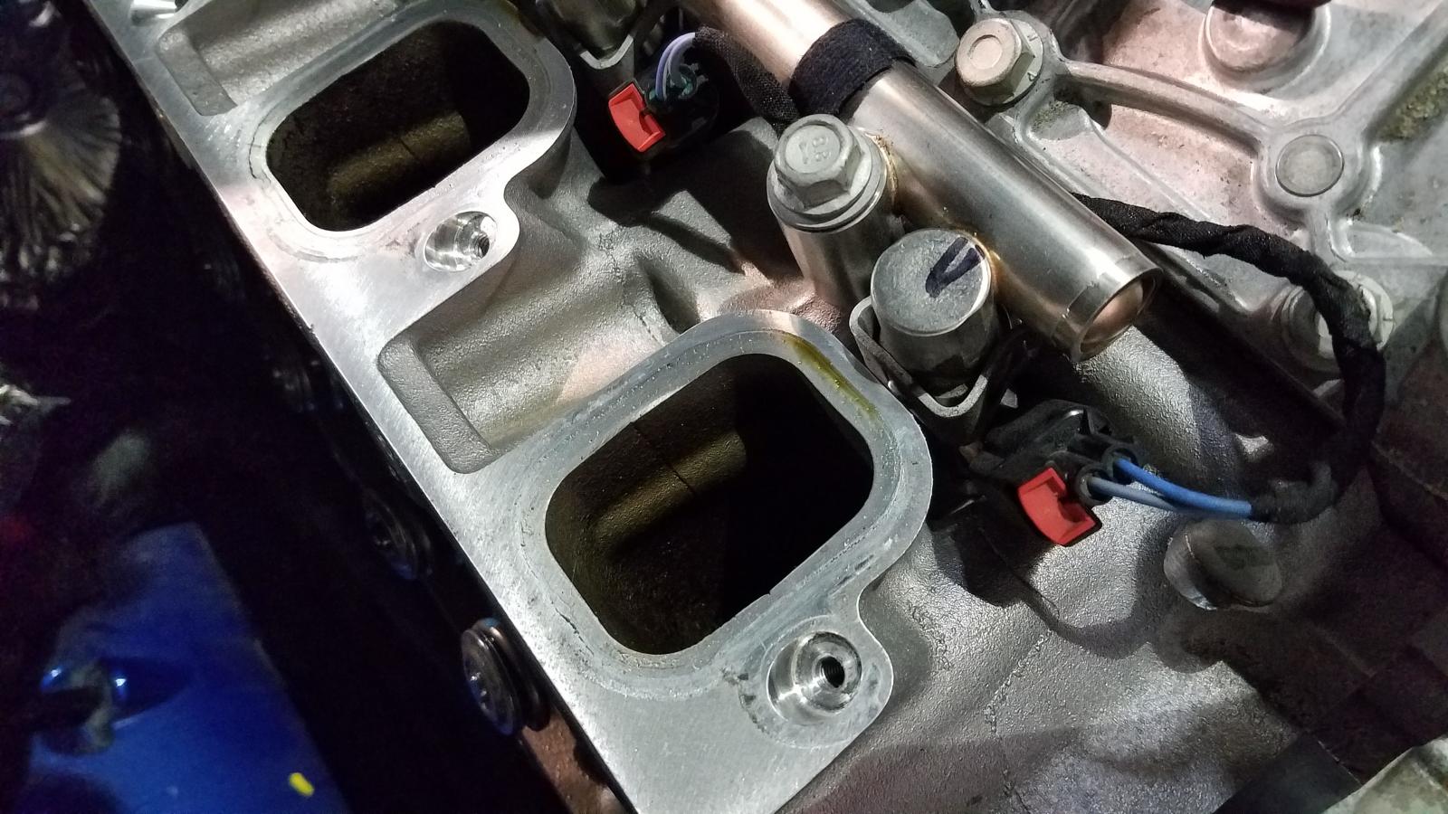

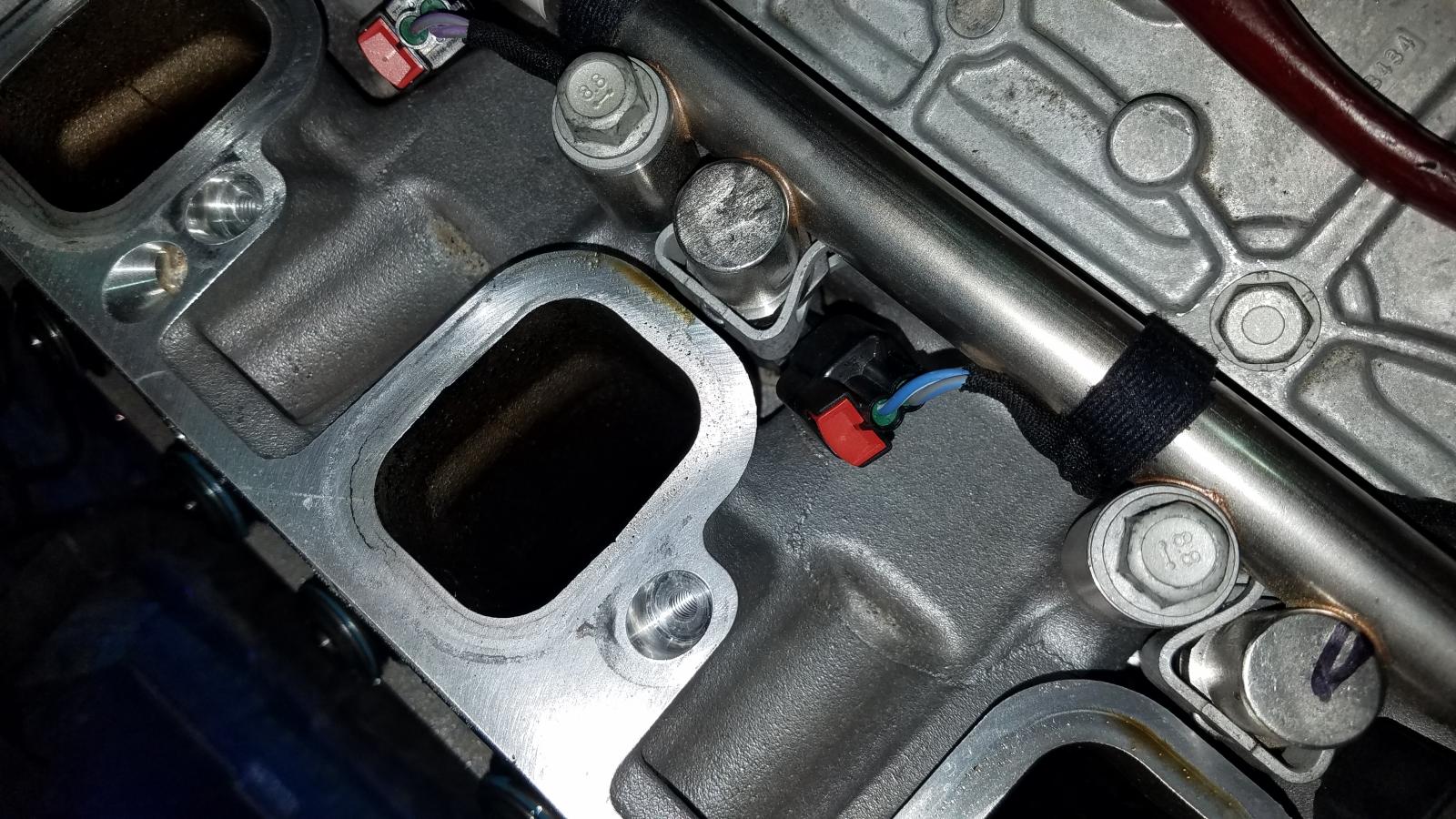

Intake valve build up
I installed our ported intake manifold this evening and took a pic of one of the intake valves. My car has about 15.5K miles. The Mishimoto catch can has been on for about 14K of that.

Ummm. Is that good or bad?

Do you have a non-catch can pic to compare?

That looks much better than I thought it would at 15,500 miles...now is it just how these engines are, or did the Mishimoto catch can help this a lot?

I would say not bad. Some Seafoam every 10K miles or so should keep things in decent shape.
The catch can definitely helps. I empty it every 2500 miles or so and it is definitely accumulating oil that would otherwise end up on the valves.

Don't think I could bring myself to do this...if yours look that good after nearly 16k, I am not too worried. Especially with a catch can.

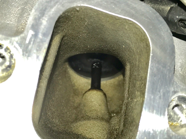

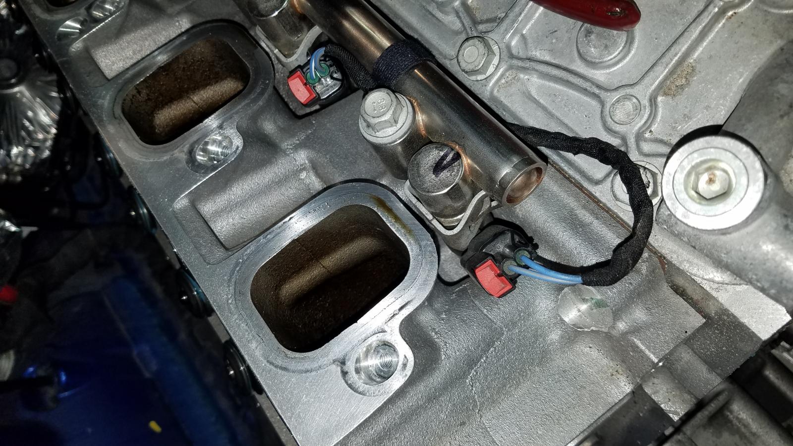

Best shot I have 19k miles no catch can
