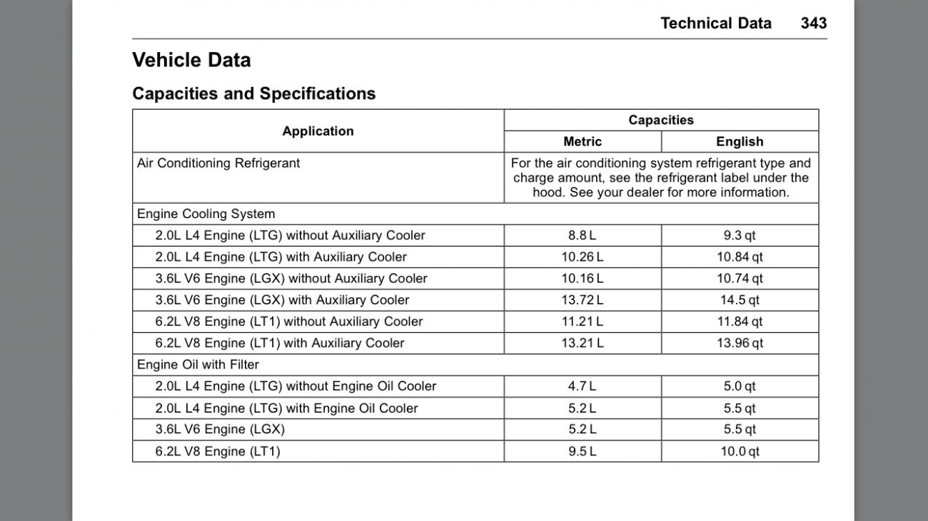

the LGX V-6 takes 10 Qts of OIL?????
No, just the V8. The V6 takes 5.5 quarts. The 4-cyl takes 5.0 or 5.5 quarts. Here's the fluid capacity page from the manual.
