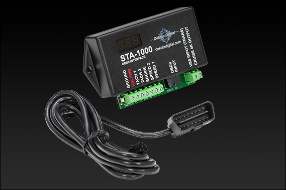

Looking at this:
http://www.dakotadigital.com/index.c...rod/prd825.htm
It turns out you can also buy an ODB2 shift light.
http://www.camaro6.com/forums/showthread.php?p=9592700

The STA 1000 is the solution to the shift light blues. My conclusion is you need a ODB2 signal pick up for your shift light. You can buy a light with the ODB2 setup or add the STA 1000 to your favorite light. I really like the Autometer guage with the Aeroforce pod. The light is in the pod and up high. I can't wait to test it out.
