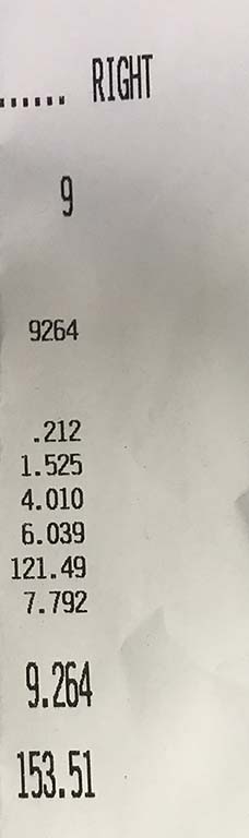

With that in mind - the solution was to launch in second which resulted in:
Attachment 941432
Our 60' increased from a "prepped track" value of 1.39 to 1.52, but still a pretty respectable ET and MPH. Unfortunately after about 8-9 passes we began to notice some transmission problems, I think the transmission is still OK, but I believe that we have failed the lockup function in the stock converter. At least that is what the data looks like.
At this point I have no plans to continue to run the A8, we will be switching to a TH400 with a higher stall converter which I believe will ultimately be a faster solution in this car. Once the A8 is at this power level I don't think there is a good answer - it is near it's limit and shifts to much costing you precious time with every shift. Each shift requires 0.25 sec with ignition timing at about 0 - that's over a full second of a low 9 sec pass with heavily reduces power. The TH400 will happily shift under full power.
