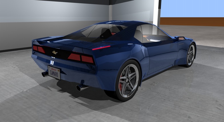

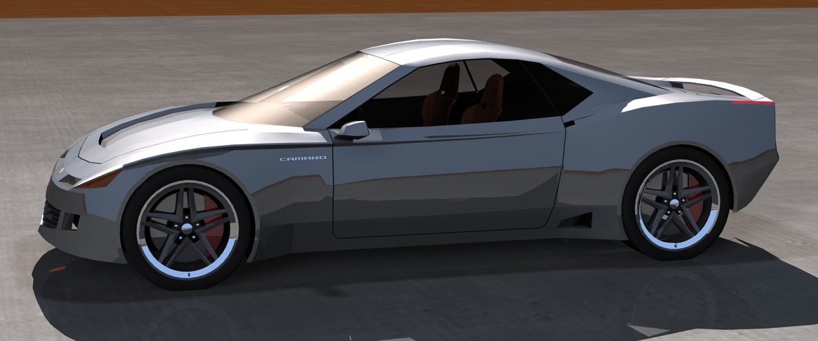

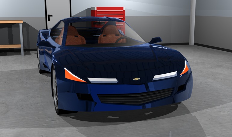

Here's the latest with a few changes. I moved the radiator exit cutout on the hood back a bit. Starting to experiment with some LED lighting on the top of the fender edges.
Attachment 597289
Attachment 597290
Attachment 597291
I see this...

Here are my thoughts on the design:
- The rear braking duct for cooling just behind the rear doors has to go. I just don't see the purpose in it. It's not a Corvette or a high end exotic and it doesn't go with the flow of the car.
- The curved fenders at the bottom of the wheels have to go. These will just make it very hard to jack the car up and get a tire off because the tire won't drop with the suspension, and if it does the tire will bottom out on the fender possibly wrecking them.
- I think the front end really does look Corvette "like", Square it off a bit and add in a small upper grill for cooling. And with the big signal lights on the side, integrate the headlights into them will make for a better flow (HID projectors would look nice).
- I still see the roofline as a bit too high, but maybe with squaring off the front end a bit that might help with hiding that.
- The back end needs a rear diffuser around the exhaust pipes to hide them a bit. They hang down too much like a 60's muscle car.
I am not trying to be to harsh, just giving my honest opinion. It is great that you are doing this and it will be fun to watch the progress of your design. Keep it up!
The rear cooling duct is intended to be functional; especially since Camaro owners take their cars to the track. I'm guessing you don't but I certainly do and I know others do.
I'll try the HID's in the side lights; might work.
I haven't done anything with a diffuser in the back but that can be added. The exhaust pipes fit beneath the rear cowl as-is, so I didn't put a diffuser in it. But I can play with that if people feel that's an important styling feature.
I really appreciate the time those who are putting in constructive comments are taking to put in their suggestions and feedback.

Based on feedback, here's a few snapshots with a revised cabin. I lowered the roof a couple of inches, moved the base of the windshield back 4 inches, moved the entire front of the cabin including the A pillar back 2 inches, moved the base of the rear window forward 2 inches. This sounds like it wouldn't be that much work but it took me almost 2 hours of tweaking to get this to look right. I was surprised at how just lowering the roof threw off the entire look, and how much work it took to get it all rebalanced.
I also straightened the bottom of the fender well edges. As someone pointed out, the previous design although I thought it was cool looking, would have been impractical when trying to remove a wheel.
