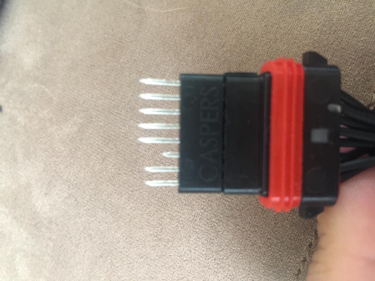

Anyone have a link to a better MAD extension harness? Procharger one sent doesn’t work and having the same issues as this gentleman here. Thanks

Maybe this will help.

Ordered it, thank you
