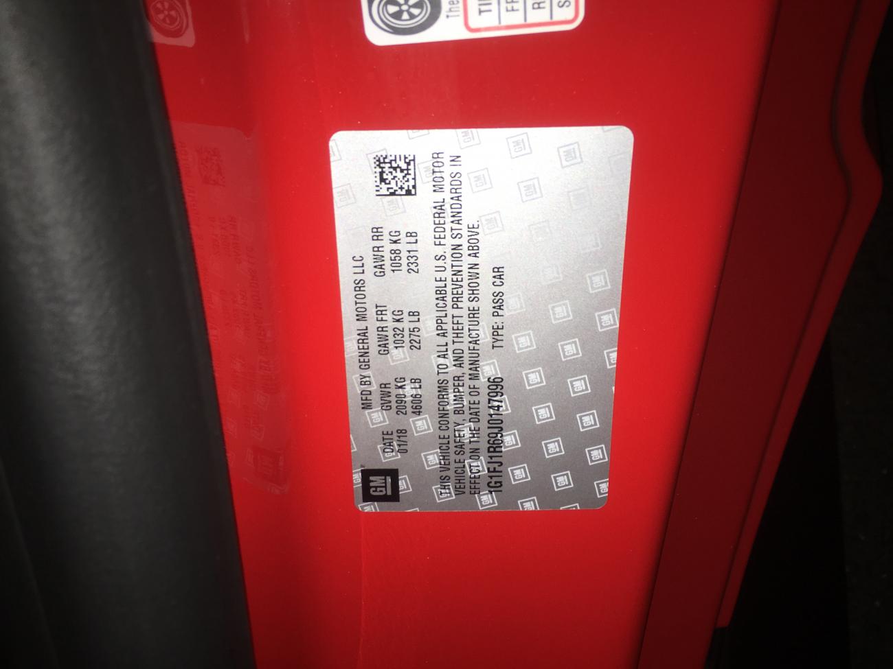

Hi guys. Just got my first paint chip !!!!! Right above the right/rear wheel. Hard to imagine how that happened. But the paint is gone, down to bare metal. At least there is no dent on the metal.
I took a picture of the sticker in the driver’s door jam and the one under the hood. I want to make sure I am not loosing my mind....... I don’t see a paint code anywhere on these stickers !!!
Can someone confirm the paint code on this website is correct?
http://paintref.com/cgi-bin/paintdet...20Hot%7C186393
They say it’s G7C or WA130X. I guess GM has two names for it.

That QR barcode on the second sticker is the RPO SPID label now. Won't find the traditional one like in that link above. All 2018 cars (except Corvette) its in the QR barcode. A phone QR reader can read it.
A couple of explanations on the switch to QR SPID labels:
http://sandyblogs.com/techlink/?p=7888
http://sandyblogs.com/techlink/?p=9801
Red Hot is RPO G7C, paint code is WA130X.

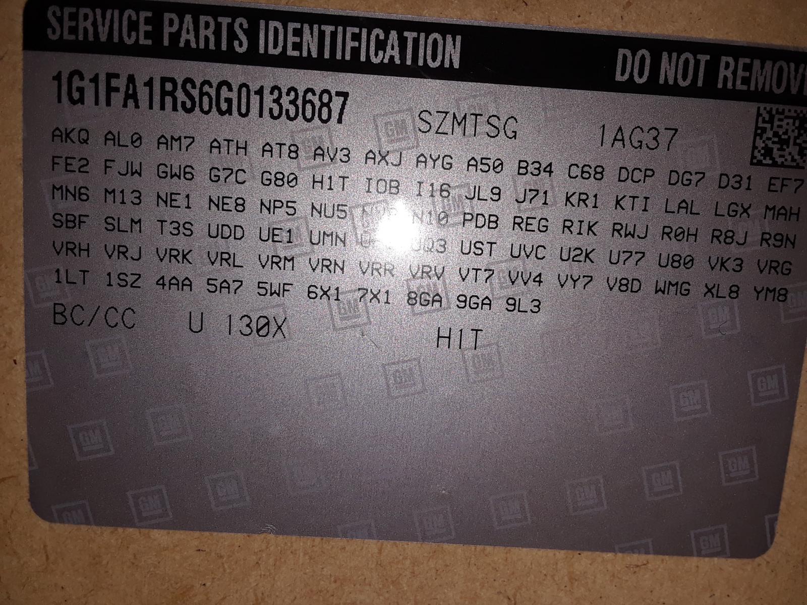

lift up the trunk floor cover, there is all the codes on the silver sticker, paint code is on the bottom, BC CC is base coat clear coat. This is my red hot 2016.

lets try that again

Paint code U 130X
Thank you sir. Here is the actual GM part number for the touch up if anyone else needs it.
19367657

"Variations of the exterior paint code WA130X, which may appear on body data tags include: 130X, U130X, and L130X (the prefix U for upper body, or L for lower body)."

Not there on 2018+ newer. See my post above https://www.camaro6.com/forums/showp...74&postcount=4
